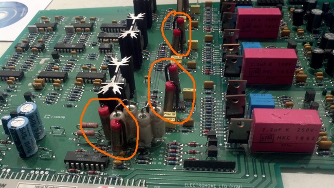

I am lucky to have some components like an LVPS and also a Focus Board...on the focus board theres one capacitor out of order (with the red cap on the upper side).
Do you know where I could buy these? I think the 30VDC / 120 MFD capacitors are not available in "standard shops" Wink

I think you are right that it is also possible to repair....by the way: Can someone tell me what kind of "capacitor" this one is...I have marked it in the file attached. It says "CMT 30 VDC / 120 mfd"...but I can not find a capacitor looking like this at my known shops.
