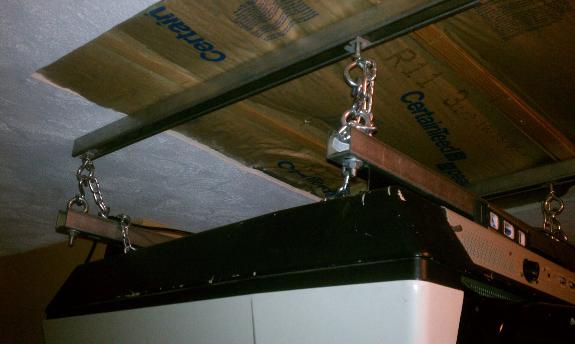

Does anyone have a picture or diagram on mounting a Barco 1208/9 using channel strut? Am I supposed to drill holes in the leg rails?

This is what my strut setup looks like. I drilled no holes.
