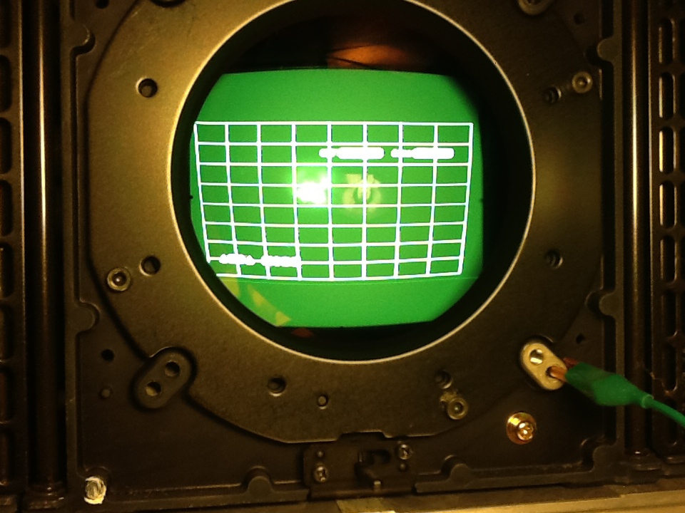

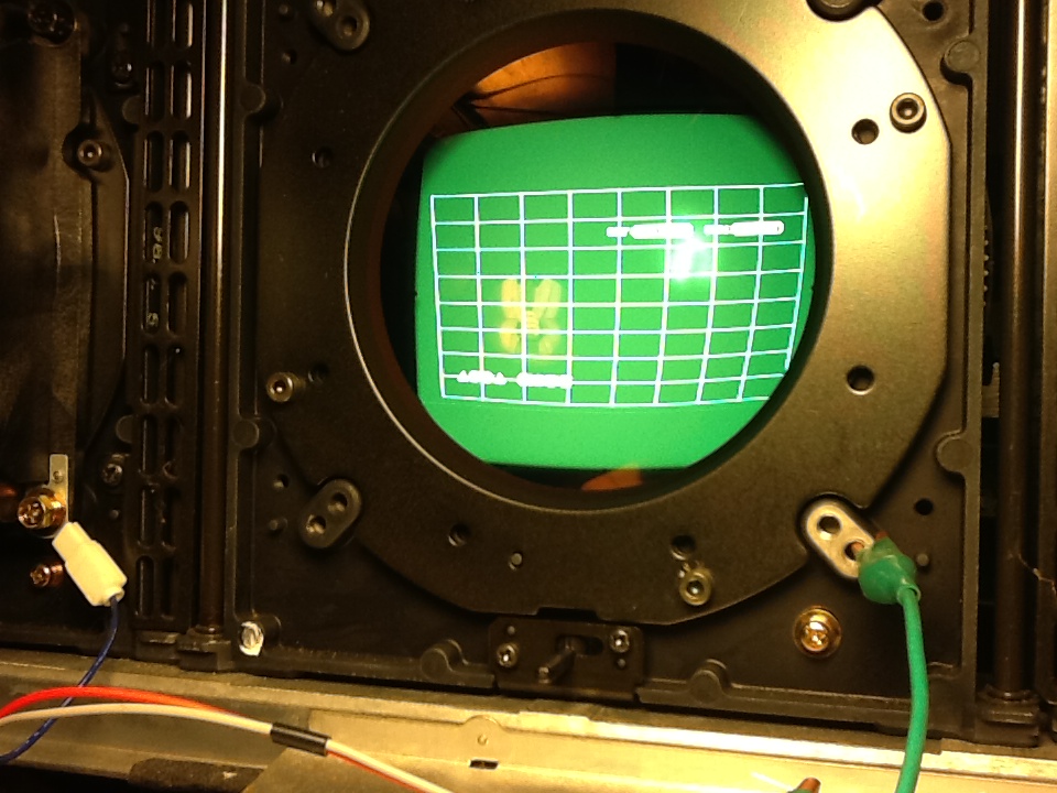

Not using a calculator.
I have the PJ on a small table.
I currently have an 80" wide screen.
Back wall to screen is 135"
The back of the PJ is 6" from back wall.
The front of the PJ is 113" to the screen.
And I'm getting 5" of extra image on both sides of my 80"screen.
Do you think I can push the crosshatch pattern closer to the tube's edge?
I think I'm maxed out just enough?
I think (eye balling) the top edges of the hatch pattern are about 5mm from the edge of the tube.
I can't move the PJ back anymore.
But I can move it forward 4" to 5" max.
I think the manual suggest 12" minimum behind the PJ.
I could probably move the screen back 3" to 4" max.
But not sure if that would be enough to get me to 92" ???

Posted: Tue Feb 14, 2012 4:55 pm    Post subject:
I think we should clear up that Matte White is not 1.3 gain. Matte White is exactly that, it's matte (flat with no gloss) and it's 1.0 gain. In the 1.3 range like Draper 1300 and Studiotek G3 there is some gloss or reflective element added
bachiano wrote:
I think I'm pretty much stuck with 87" as my room length will not allow larger.
if your stuck with 87" how is your PJ projecting 80" + 10" ?

Posted: Tue Feb 14, 2012 5:16 pm    Post subject:
Yes, matte is technically 1.0. 1.1 is still quite matte, and 1.2-1.3 less so.
Looks like you're pretty maxed out. 5mm is about as close as you want to get. You'll already be sacrificing some corner focus, but I don't think you have a choice. Looks like you're on top of it, and from the sounds of it, I'd stay with the 87. Let's run the numbers though based on your setup... It's all linear if you assume the image size stays where it is on the tube face...
If your throw is 113 and you're getting a 90" image (80+5+5), then to get to 92", your throw would only have to go to 115.5, or 2.5 inches longer than it is now. If your screen go back 3-4", then you could probably move the screen 3", and the projector out from the wall .5". Or, you could stick with 87" and have a little more breathing room.
You should be fine with the projector where it is... Don't forget these machines were designed for industrial use in harsh conditions 24/7, so there's a lot of margin in the engineering specs. You should be fine at 6" behind the projector. A bit more would be nice, but since the front of the machine is open, and it's (presumably) a house you live in, it shouldn't be running in extreme heat, so you're fine.
I'm not a big high-power fan because I don't like the narrow viewing cone and the changing gain as you move in and out of the center. How about Video Spectra as a compromise between the two?

At 113" throw even with the lost 5" on each side of the screen,
the image has lots of punch at 50 and 70 Brightness and contrast on my 1.0 gain.

Real world throw distance for a G70. 92" wide at ~115" to the green lens rasters maxed.
http://www.curtpalme.com/forum/album_page.php?pic_id=1152
If you are indeed 113" screen to PJ that is virtually what I have so 92" wide is possible. Although your back wall dimenssion would need to be more than 135" I think.

Right now I'm 113" from the bottom lip of the green tube.
While I can't move the wall back, I'm pretty certain I can move the screen location away from the PJ by 2 or 3".
Will that be enough to get me to 92" ?
It has been said before that getting too close to the edge of the tubes causes geometry problems with the G70.
Afryia. Do you have geometry problems with your rasters maxed out?
Thanks for the drawing. It's very helpful to see it drawn out like that.
