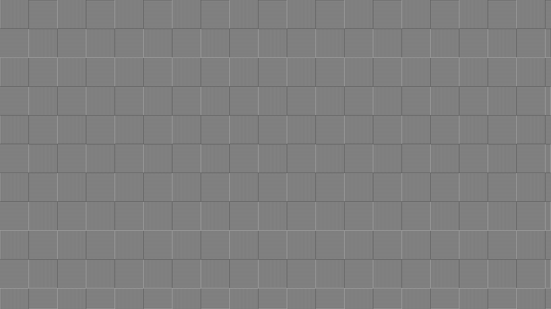

Posted: Wed Feb 08, 2012 4:46 am    Post subject:
here's a good one.
 Filesize:  31.3 KB
 Viewed:  25775 Time(s)

Posted: Wed Feb 08, 2012 2:23 pm    Post subject:
Thanks Nashou66
it's going to be interesting putting up that pattern up on my pj.
