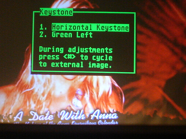

Check this out!

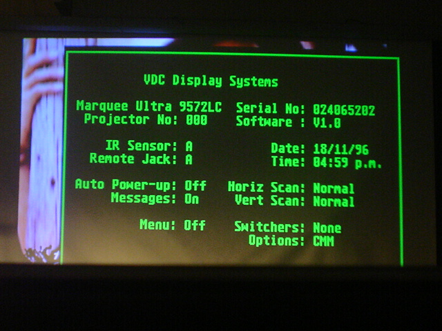

Hmm , they must have started over with a new software version for the 9572 or it was a special custom OEM spec from a customer.
What does the chip say on the CLM?

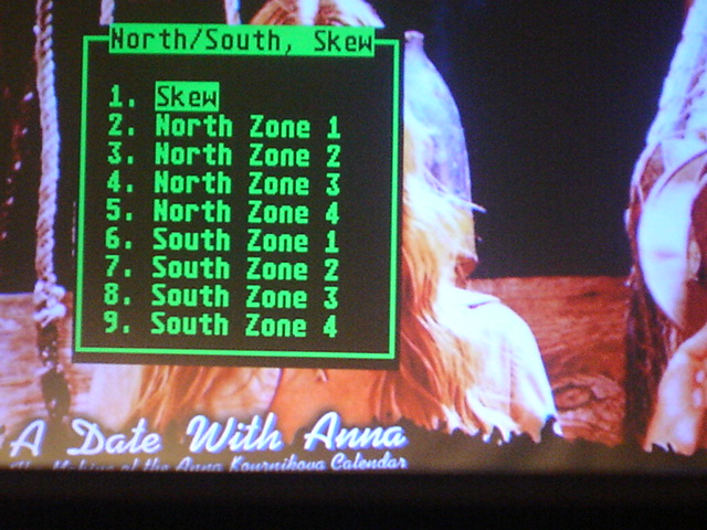

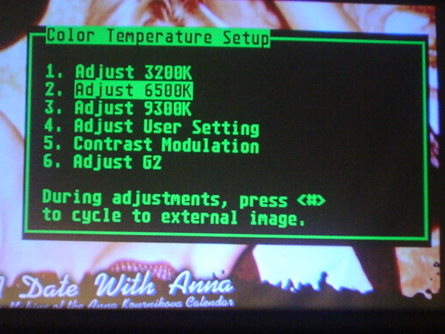

I have the Contrast modulation, and the Horizontal keystone I think but the the Green left, what ever that is.The Zone skew is kinda cool but probably only needed for a dome set up I bet.

Seems like some zone control, but, would be pretty funky to play with. then zero it after the picture gets all screwed up.

This is out of a simulator 9500. Complete thick metal enclosure of the focus board they sent in as well. additional shielding on the CKM as well. Strange problems with this CLM- intermittent loss of the H direction of geometry. Power down, power up, and the H convergence and geometry is lost. Off and on again, and it comes back. Go figure. Cleaned all socketed chips and module connections, it hasn't done it since.

Strange with the CLM, normally contact problem, but is not pointing that direction.
