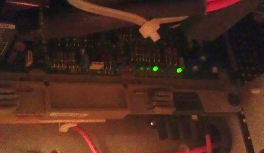

Today I noticed that the Standby red led at the back of the PJ is off.
After a short check, the fuse F1 at the Power (mains) input module was bad.
replacing to a new fuse doesn't help,it continue to explode. finally I replaced the input module to another one.
The Standby red led is ON but the PJ didn't start (no fans no picture)
Looking to the G2+DIAGNOSTIC board I can see only few green leds are on for several seconds and then it's go off.
Is it the SMPS ?

Posted: Fri Feb 03, 2012 10:12 pm    Post subject:
Yes, most likely, unless there's a dead short in one of the modules that the SMPS powers.

Thanks, I have some spare modules, I checked/switched with my spare:
G2+DIAGNOSTIC
HORIZONTAL DEFLECTION
MAGNETIC FOCUS & HOR. SHIFT
But NO-GO
So we can say it is the SMPS or should I find locally & check another module just to be sure it is the SMPS ?
Posted: Fri Feb 03, 2012 10:28 pm    Post subject:
I'd swap the SMPS if you can. If not, I can repair it.

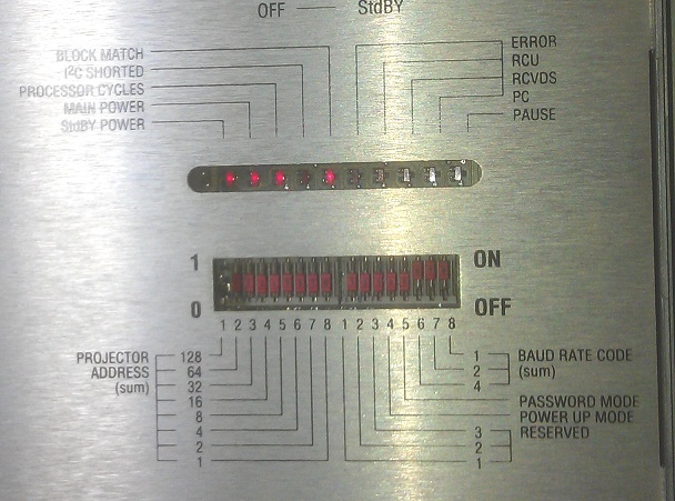

Is there is a possibility that while going to the "Service Mode" or the "Installation Adjustment" in the Menu I disable the possibility to adjust the contrast and the brightness ?
Thanks for any idea.
Attached is a picture of the controller board.
 Filesize:  114.81 KB
 Viewed:  2911 Time(s)
Posted: Fri Feb 10, 2012 2:17 am    Post subject:
OK the remote doesn't work, but do you still get a picture? If so, then press the 'addr' button on the remote and press 0,0,0. that will reset the remote to address 0. Also do the same on the wired remote on the projector itself. Also try changing the remote battery.
