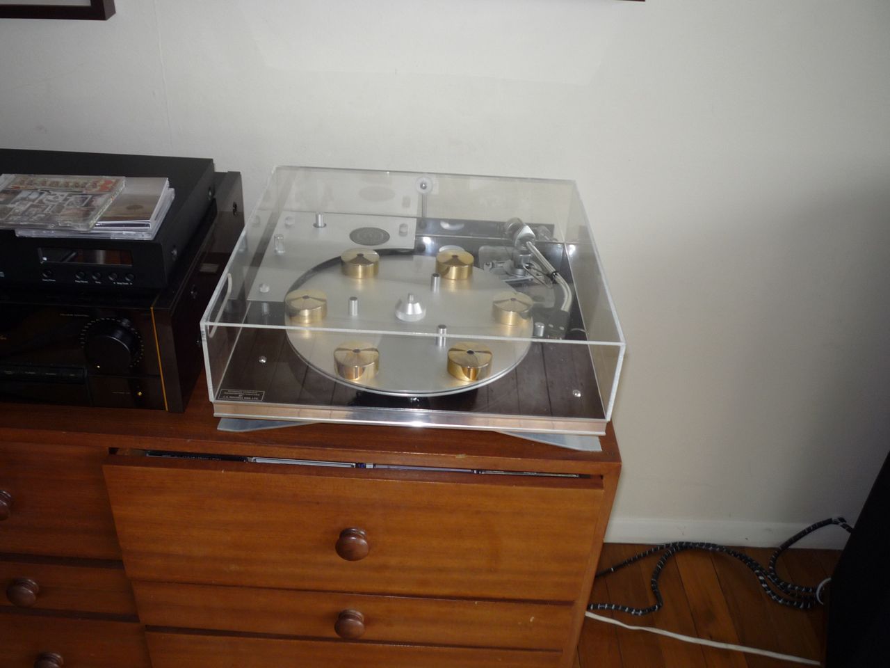

my wife bought me this...
 Filesize:  97.13 KB
 Viewed:  24834 Time(s)
That is sweet!!!
What kind is it?

Posted: Wed Feb 01, 2012 11:37 pm    Post subject:
it is a michell reference hydraulic. a late model transcriptor, as featured in clockwork orange. it dates from the early seventies...

Nice, how much it set her back if you don't mind me asking?
nettwerkjohn
Posts: 921
Posted: Thu Feb 02, 2012 12:05 am    Post subject:
it was a steal - the seller didn't know what they had. i think she paid around $700NZD, so $500 ish USD...
they typically sell for around $2-$3k over here.
i've since put a very good ortofon low output mc (Kontrapunkt A) on it that cost more than the TT, but it now sounds better than a friends Oracle Delphi...
i've considered putting a SME V on it - as I have a full set of NOS spares (motor, bearings etc) that I have just purchased from the original manufacturer in the UK...
