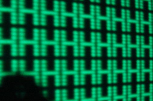

Here a sample, not as good as it shoul be, but you 'll get the idea how the 'H's look.
You will need to try your best with mechanical focus, and the best way is do the mod for the lenses ( as 'Mooneyass' sugest
) and then go further with the magnets.

A special thanks for the photo! A picture is worth a thousand words. I can get nothing like that at the moment. I can see the scan lines but can't differentiate the individual parts of the H. The blobs blend into each other.
I knew, and wasnt expecting 1209 performance from my Sony. But, when the manual says I should be able to see the blocks of the H, I'm concerned when I cant. Knowing that it should be acheivable, and having a picture that shows what is possible is invaluable.
It looks like I'm going to have to delve into the machine...... I'm convinced Ive done the best job possible on the mechanical focus.... where's those rubber gloves?!
I can now go away and try and replicate that, so thank you all.

I can now get an H patern showing the discrete parts of the H like in the manual and the above photo......
But only on a channel with no input to it.
If I try the same test on the input I use from my HTPC then I still have the same issues as before. i.e. the H blends into a solid figure with softer edges. I have tried a multitude of resolutions and frequencies with little, if any, change.
