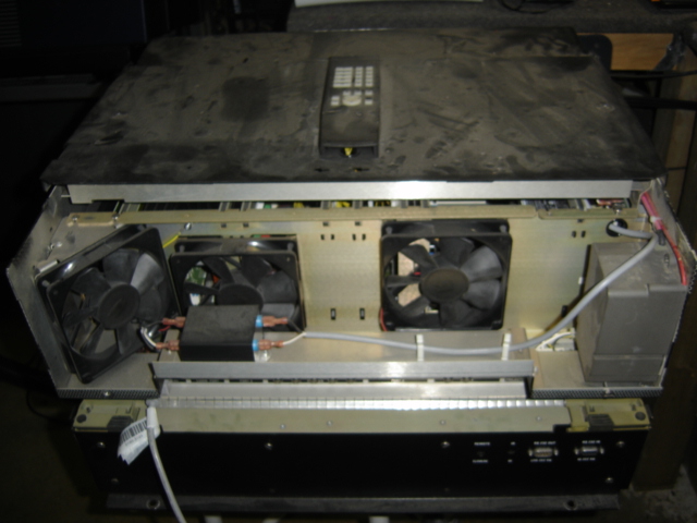

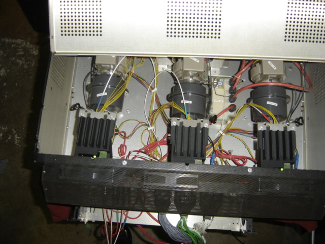

Splitpack Cine 8 basically. Nov 2001 build. Minty fresh Sony 8" tubes.

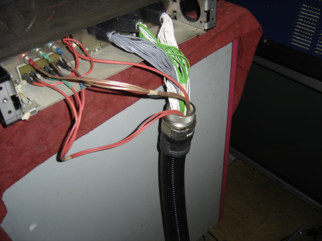

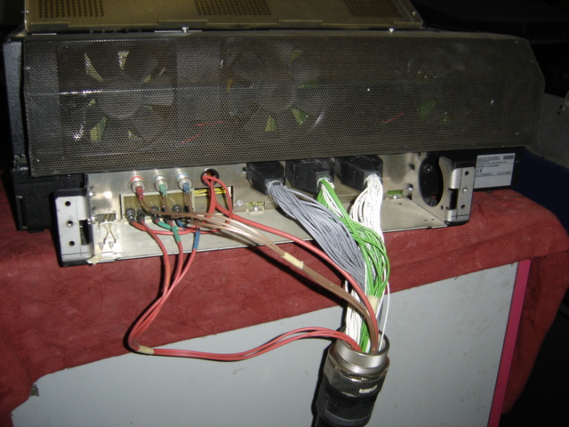

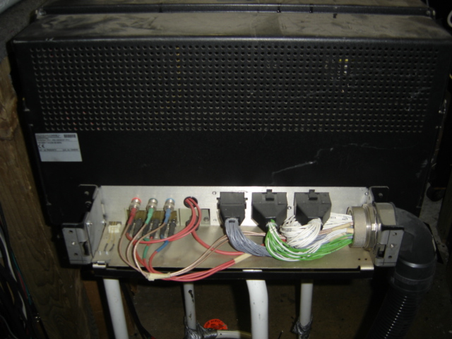

What I find interesting is that these are supposed to be super high res sets, but the yoke cables are in the same wire bundle as the video cables. Ditto for the unshielded HV lead. It goes to a splice block, then out to a HV extension. Very interesting.
NOw there's no HV, I'm checking that out now....

The Cine 8 made some slight mods, like SMT components in the V board. I know there are some mods to the convergence board. It looks the same as the discrete output 1208 convergence output board, but this one is labeled 769004. The stock 762519 doesn't work in its place, even though it looks the same.
The stupid thing is, I had an email yesterday from someone looking for that 769004 board, 2 of them, and now I've got them. Barco has discontinued them, so I'm torn between keeping these, selling them whole, or flipping the convergence output boards at a good price.
About the only advantage of these sets otherwise are the (supposedly) sharper Sony tubes.
Of course with no wear, I can sell a set of those at a good price as well, or drop them into a couple of the BG808s sets I have here with roasted tubes.
Working on the HV section now. ONce I get that running, I can get an hour counter reading. I believe that one of these might be a spare, so besides the dust, I think it could be a new chassis.
