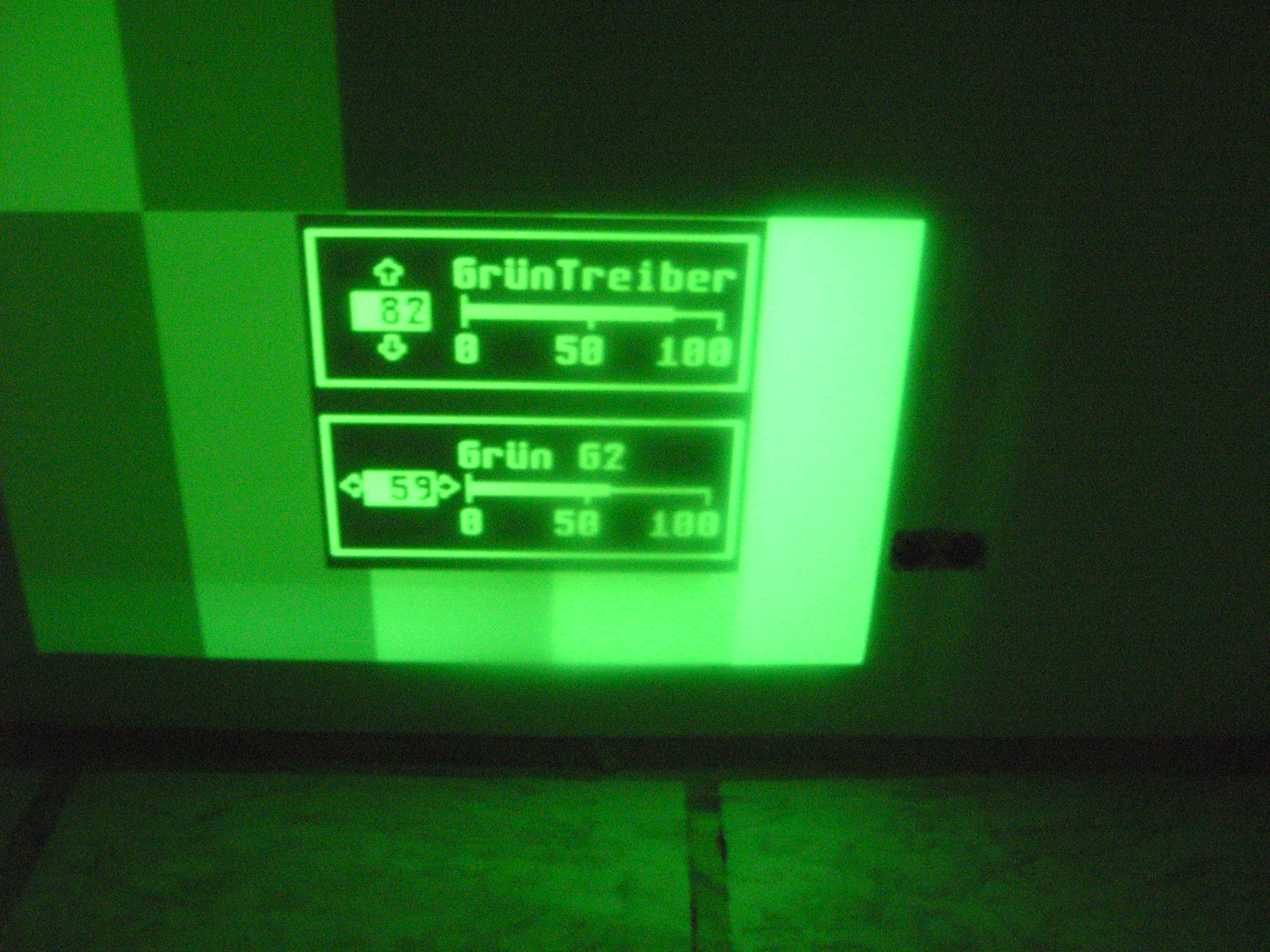

After sorting out the major issues i had with the Marquee 8500LC i bought a few days ago, i thought i open a new thread with the remaining issue.
I managed to get everything working so far (even the U7 chip). After reseating it , the Marquee had no more troubles sofar in that department.
Spent almost the whole day on getting the basic picture "functional" , cause the previous owner screwed everything up very badly.
My question...
On the Green Tube in the right corner un-sharpness is visible. (I went through the whole Setup, and it's only visible in the right corner and only on the green tube).
Could it be mold or blooming ??
Sorry for the really bad photo quality but i only got my crappy smartphone camera at the moment.
Thanx
Ronald

| Posted: Tue Oct 25, 2011 10:01 pm Post subject: |
It be best to remove the lenses and look into the the tubes with a flash light.
But to me it looks like either fungus or at worse the C-element might be damaged in that spot.
The C-elements are made of acrylic and if any sunlight gets shined into the lens it will fry the element like a magnifying glass does to ants.

Bodi79
Joined: 08 Oct 2011 Posts: 130 Location: Austria
| Posted: Tue Oct 25, 2011 10:08 pm Post subject: |
@Nashou66
I actually removed the lenses earlier.. the C-Element looked good couldn't make anything out.
Guess it's fungus than.. that sucks.. must remove the tube than and clean it (read the tutorial 5times already)
Thanx again
Ronald

Joined: 12 Jan 2007 Posts: 16171 Location: West Seneca NY
| Posted: Wed Oct 26, 2011 3:07 am Post subject: |
| Bodi79 wrote: | @Nashou66
Thanx again
Ronald |
You can try to clean it but the age of the glycol and trying to clean out the chamber with out destroying the bellow
is not easy. It can be done , however if any small amount of fungus or if the anodizing has left exposed areas of bare aluminum then the fungus will return rather quickly.
the easiest way to inspect the chamber is to cut the old bellow out and replace with new.
This way you can check the faceplate for corrosion and then paint it with epoxy if need be.
Also its much easier to tear out and replace than to try to drain the old glycol through the tiny
fill holes and then fill with cleaner, which you'd have to shake to clean the fungus which in turn
might cause contaminants to get on the guns and cause other problems of the tube internally.

zGman
Joined: 22 May 2006 Posts: 599
| Posted: Wed Oct 26, 2011 3:47 am Post subject: |
Yes - a new set of bellows and new glycol is a wise investment to prevent future
problems with probable leaks and corrosion (fungi doen't really live in glycol -
just looks like it) Now that you have sorted out your running problems, a little
basic maintenance will help assure good performance for years down the road.
You can also source stainless fill screws and try to find a red c-element....
G
