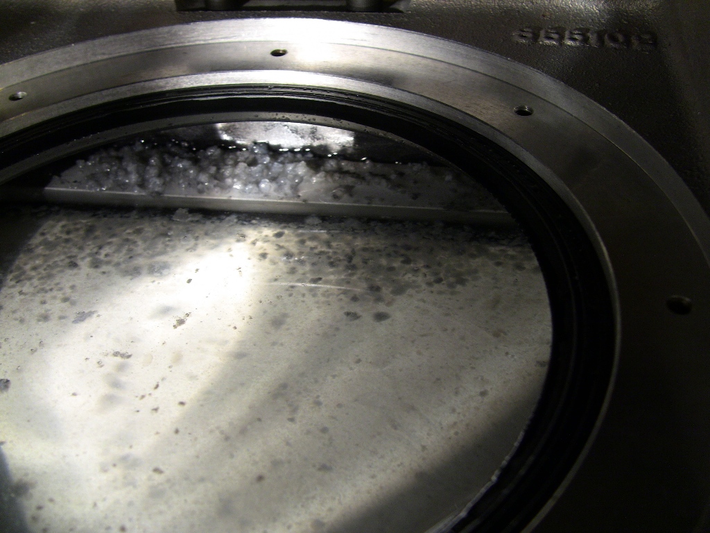

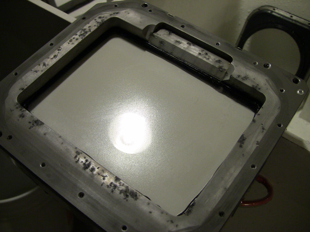

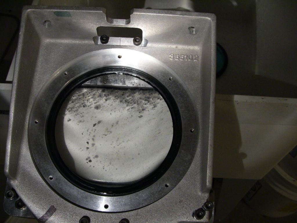

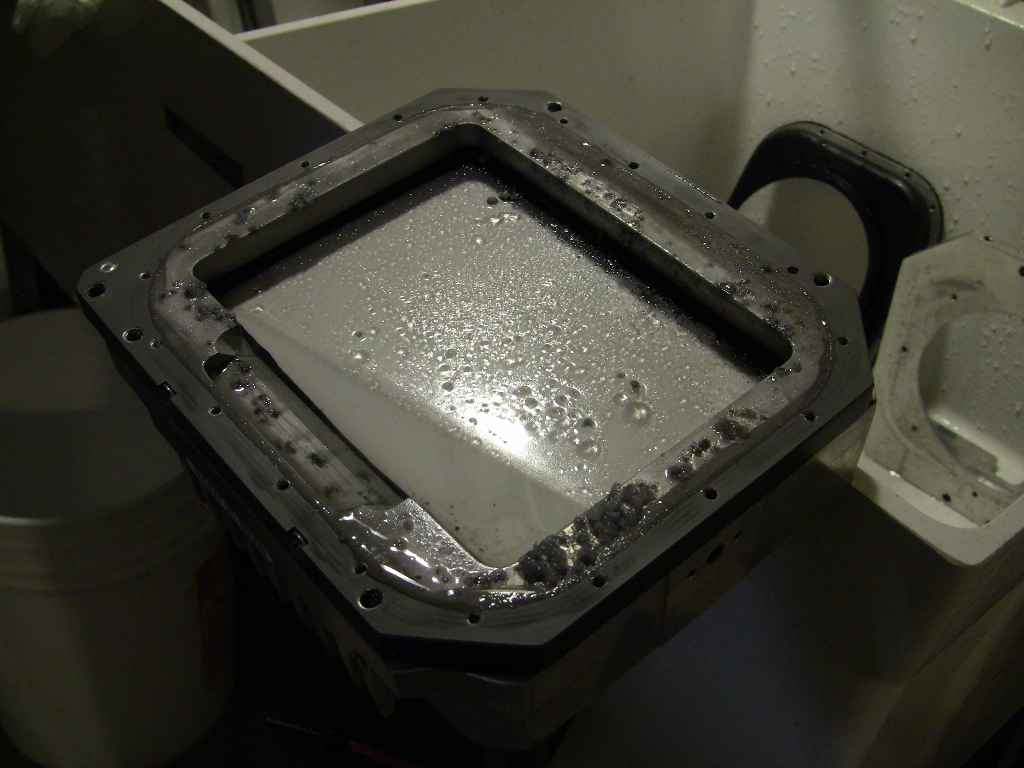

Some months ago I changed the bellows on my MP9, but for various reasons, such as my interest in getting G90 focus yokes in it, it has sat disassembled. Today I was in the process of building harnesses to install the G90 yokes and discovered serious debris in the green tube and the start of what looks like the the same problem in the blue and red.
When I did the bellows change, I thoroughly removed with razor scraper and 3M pad and steel brush (and boy, was it tedious) all remnants of the RTV that was on the inner casting courtesy of the previous bellows. Maybe I did too good a job, because I must have gotten the anodization super thin. I installed clean new Athanasios' bellows and charged with the glycerin based coolant Dragan has been using lately (no ethylene glycol). And then they sat for many months.
At first I thought it was fungus, but after a quick strip down, it's clearly material being created by a chemical reaction between the coolant and the aluminum casting. The debris is like salt. No, I didn't try tasting it. Wink Severe pitting can be seen on the casting.
I suppose the solution will be to either a put a thick, baked enamel coat on these inner castings or anodize the crap out of them. In any event, it means separating them from the tube and the rear most casting. I have done this already with in the interest of using the piece as a template for new design machining brand new ones for a future ultimate Marquee build. Yeah, like I got time for that.
So, damn. Now what? Mask off tube and spray paint flat black, as I think I've read others have done?

Well, it's not working so great for me and I'd like to know why. The results speak for themselves. The chamber was completely clean before I put this stuff it. And the beginnings of what looks like the same problem seem to be taking shape in the other tubes, including one assembled by Dragan.
Thanks,
Steve

The brand new bellows were very clean, I'm sure of it, as were all other internal surfaces (casting, c-element). In one of the photos you can clearly see the formation of the material right at the sites of pitting.
The company responded saying the stuff it totally safe on aluminum and that there had to have been remnants of ethylene glycol or something else present to make it do that. I do remember that there was already a trace of pitting from before, and maybe the inhibitors were going after that corrosion. I had worked over the casting with a razor scraper, 3m pad and a steel wire brush. Maybe there was some steel that got imparted to the aluminum and the inhibitors were interacting with that?
Assuming this stuff is safe on aluminum or anodized aluminum, it must be some variable I introduced. Embarassed
Steve

I'll stand behind the one I did, if you send it to me I'll redo the chamber without disturbing the bellows. What I have done to the last few I did was paint all the metal surfaces with 2-part automotive Epoxy. I think at this point it's just something you have to do to any old marquee housing. I started doing this after a set I did for myself started clouding up and corroding after sitting for just a few months.
I can also send you some of the Epoxy if you want to do it yourself. I just paint it on with a small brush and with the tube sitting up vertically like in your pic. If some gets on the inside of the bellows it's not a problem. Let cure for at least 24 hours or longer.
bottom line= MArquee LC housings are crap Sad
