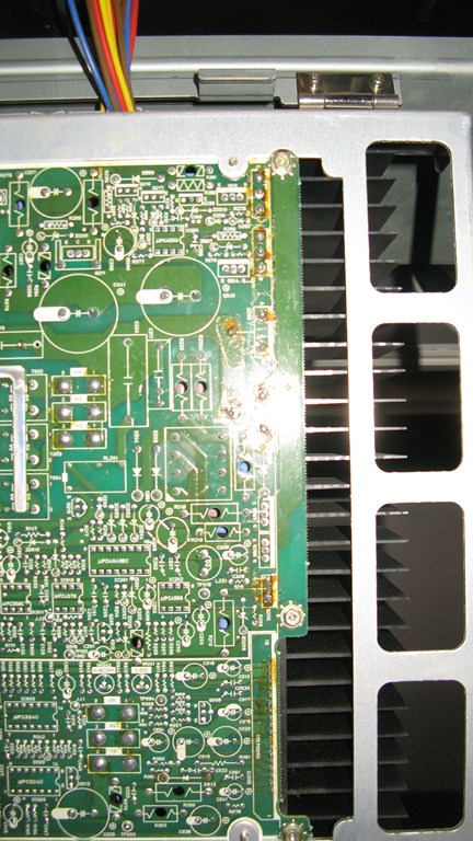

Had a closer look at the boards. The deflection board looks like a cap has been leaking onto the bottom side. Brown crap stains along the side closest to the system/wave cage. Next time it starts up I'll check and see if the H led goes out. It seems to stay on while the unit attempts to fire up. As soon as I hear the tubes crackle the projector shuts down then will try and start again until unplugged.

Here is a photo of deflection board

Posted: Tue Sep 20, 2011 5:54 pm    Post subject:
No, that's flux, that's normal. If the HV is coming up, then my guess is that the deflection board is OK. Leaking caps most likely now are throughout the set, and any one could trigger the shutdown or lack of H sweep (or did it collapse vertically?)

Had a closer look at the boards. The deflection board looks like a cap has been leaking onto the bottom side. .
look here for leaky capacitors
Horizontally, from the sides to the center

Posted: Tue Sep 20, 2011 10:03 pm    Post subject:
OK, it could be an issue on the deflection board, but usually I'd suspect an intermittent drive signal. Keep in mind that ALL caps in that set are now 19-ish years old, so I'd suspect 20-30 caps that are way out of tolerance throughout the set at this point. One or more of which could be causing your problem.
