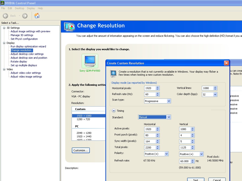

Posted: Sun Sep 18, 2011 10:52 pm    Post subject: here what I have Scott.
A little better than explaining it Scott, heres a picture showing the dot clock which is not what you gave me so I think something is wrong, this shows all the settings available to me.

Posted: Sun Sep 18, 2011 11:23 pm    Post subject:
OK, everything you need is there.
total (lines or pixels) - active (lines or pixels) = blanking
so, 2200 - 1920 = 280
You want 488 pixels for h blank. Add 208 to the total for 2408.
