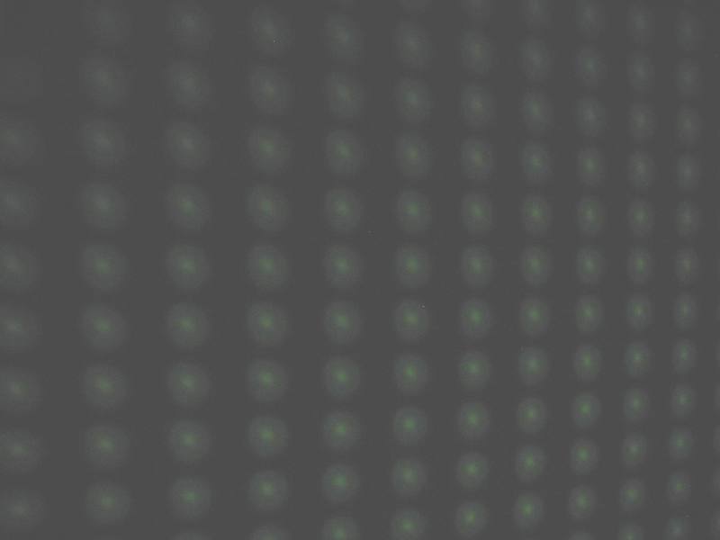

One thing I have noticed is that using the MG Focus pattern of 9 dots for the Green tube, no matter what I do, the dot has a little faint flare coming up from the top center, making it look like a little flame. Shifting the center as high as it goes does not change this flare one little bit nor does AQP/DQP and seems immune to any focus adjustments. I can purposely make the dot horizontally oval and it is still there. It is less visible than the normal small halo surrounding the focused dot.
yes flare, that's not an adjustment you make through the remote control, it's a magnetic adjustment on the flare ring on the very back of the tube. This could very well be and likely is the cause of your "ghosting".
That along with your convergence problems leads me to suspect that a good calibration would be money better spent than a $3K scaler. I'm not knocking your set-up skills at all, I messed with a couple of G70's and really never had an "AHA moment" like I did with the MArquee's I still work on and can dial in very well.
Posted: Tue Aug 16, 2011 4:43 am    Post subject:
pics

My flare is nothing like your bad flare and my defocused flare looks just like your good flare. It is when it is focused tightly that the faint little tiny flame top shows up and the softening would be in the vertical resolution but it is far less visible than the halos in your images and much much smaller.
