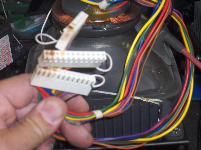

Yes, check this before using the set any more.:
Those are the white yoke connectors on the main motherboard. If ANY of them show browning or corrosion, DO NOT use the set any more. If the connections fail, you'll nuke the tubes. Gannon (member here) and I have both had that in the last 3 weeks.
Check the pins on the motherboard as well with a flashlight. I had one motherboard here start developing arcing right on the board. The pins were discolored from top to bottom. This almost always only happens on the red/blue wires on the yokes, as they use the most current.

Yikes! Ok Curt, thanks. I will pull the cover and have a look tonight. Hopefully I can get to them without pulling the PJ down Smile
Posted: Tue Aug 09, 2011 3:12 am    Post subject:
You can. Pull the connectors one at a time.

Ok guys,
I took a look and there is no corrosion on the white yoke connectors or the pins. Any other ideas? Sad

Jay,
You say there was no corrosion...the obvious burns are after a major failure...but the power connections on those molex's, the red wires, will oxodize before appearing dirty. They will merely be dingy, and it is best to clean and condition them anyways. It may STILL be the problem.
If you don't already have contact enhancer, something based on Cramolin or liquid Teflon, then I'm sure the wild guys down at Pacific Radio can set you up. I always love going in there...it is like a candy store for me. I'd use some gentle abrasive with the dab-on stuff...the spray is a waste on work like this...like a regular pencil eraser.
As a bonus, you can use the same stuff to treat all the connections in your hifi and video gear (especially turntable cartridges, headshells and interconnects)...and will most certainly derive some benefit. It will also help keep fresh the battery contacts on the video and camera gear you go on location with.
Let me know if this makes any difference, and sorry to have not answered until the weekend is finished.
