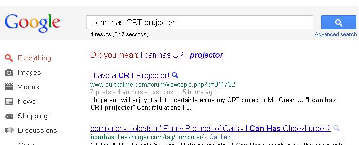

Posted: Thu Jul 14, 2011 10:07 pm    Post subject:
Gotta love this:

Posted: Thu Jul 14, 2011 10:46 pm    Post subject:
I can has cheezburger Laughing nice Razz
