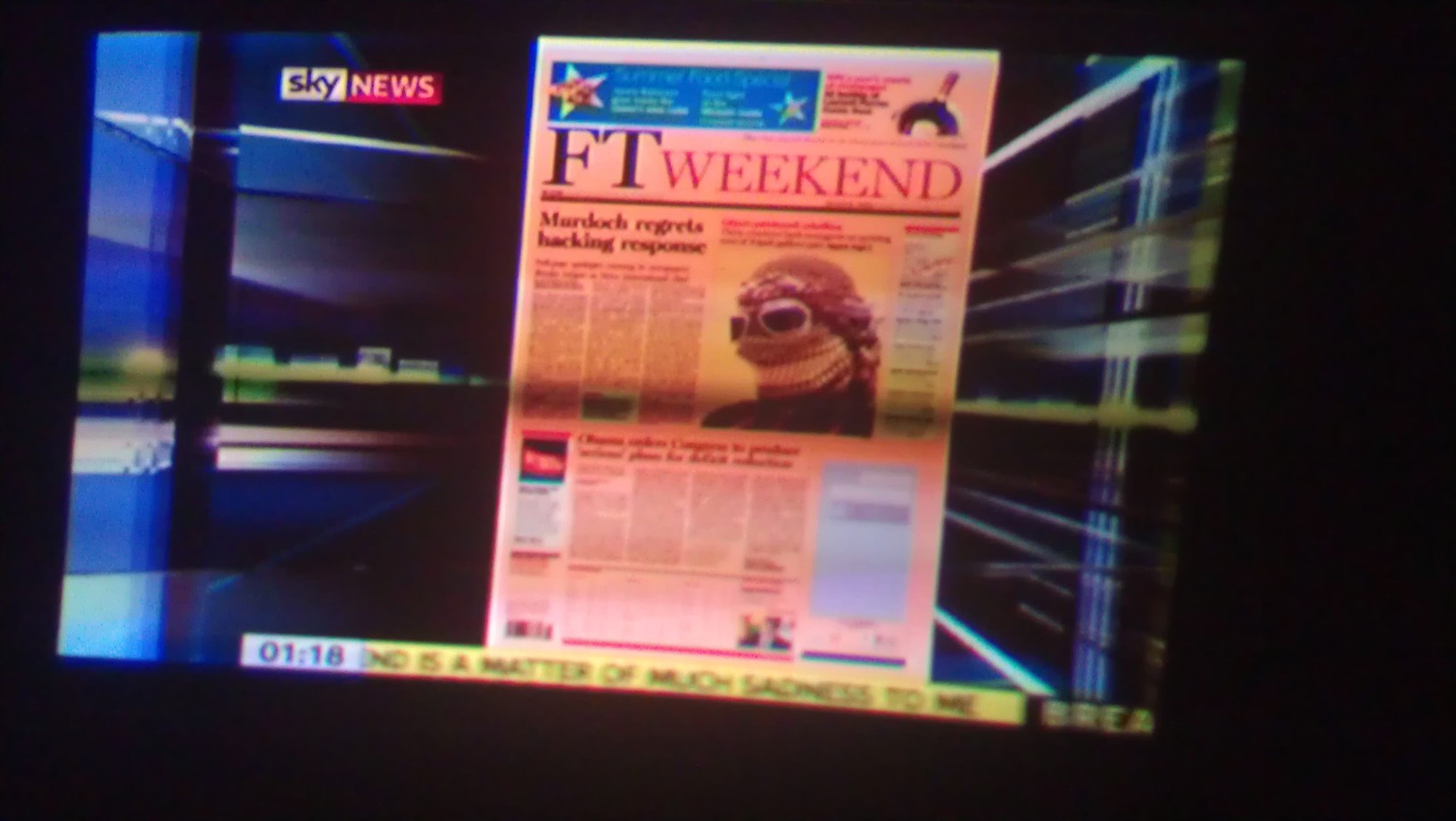

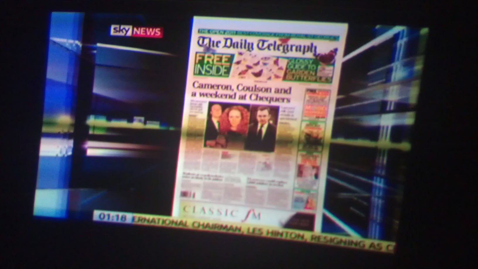

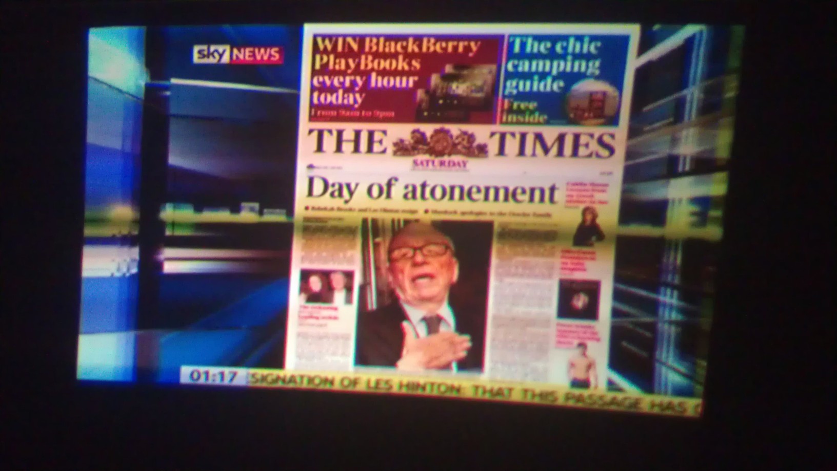

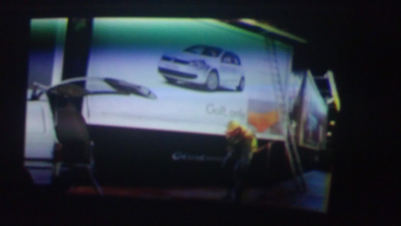

I have noticed a few faults.
On certain video scenes the video sort of fades and streaks, could this be some issue with the video circuits ? capacitors maybe? anyone have experience with these issues ? this does not happen on any menu's or internal patterns but only on video input.
when the scene changes it clears up, especially on white scenes but you cannot really tell.
Have only tested with Scart RGB and VGA and issue is on both (vga will only do 640x480 Sad for some reason, the manual specs 800x600 i think) I hope it will do 1080i !
Also I noticed another issue with the video, it is shifted to the right, (sources all 16:9) and no matter what settings i shift it will not center, looking at the tubes with the test card up it looks as though the raster is too much to the right
I have not mounted the projector in its final resting place for obvious reasons, it is currently floor mounted on a desk, but i plan to ceiling mount it once i get these issues sorted and can get someone to make a bracket for me. I get hold of this projector setup for ceiling mount and all i have done is switched the yoke connector around. The manual explains many more things such as tube washers ect, this is going to be a bit too much and since I am going for ceiling mount, I will leave all that as is. My major concern now is the video issues.

Posted: Sat Jul 16, 2011 10:23 am    Post subject:
It seems like DEF CENT (PHASE control) need adjustment. This is used to move active picture to center of raster. Phase is adjusted using live picture from source. You also need to raise brightness and lower contrast so you can look through lenses to tubes face and see picture inside raster.
480p and 1080i 60Hz should work since both are inside 30-38kHz range.
800x600 60Hz is very close to upper limit and I guess it depend about sources timings if it's below 38kHz. With 50Hz it should work ok.
