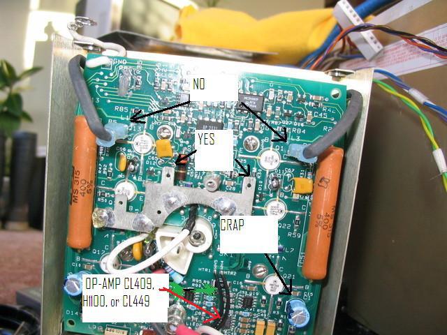

Everything is interchangeable. The 9500 was a heavilly re-designed 9000. The big pieces to look for is video input module. loosen 2 thumb-screws and slide . If it's a 50-2005-03P I would replace. Either the common 50-2035-02P or more pricey 50-2035-03P will have Blue gamma tracking and just a better board. I would also pop in a new Control module to get lots of good features like both Center and Side Vertical Linearity in the Geometry menu and also "zone" contrtast modulation for uniform screen brightness. Lastly, I would consider a newer Horizontal board like 07P or 08P .
Last but not least, neck-boards, pop off the gold cover and look at this chip. If it's the CL409 I would not use it.
 Filesize:  74.17 KB
 Viewed:  7645 Time(s)
