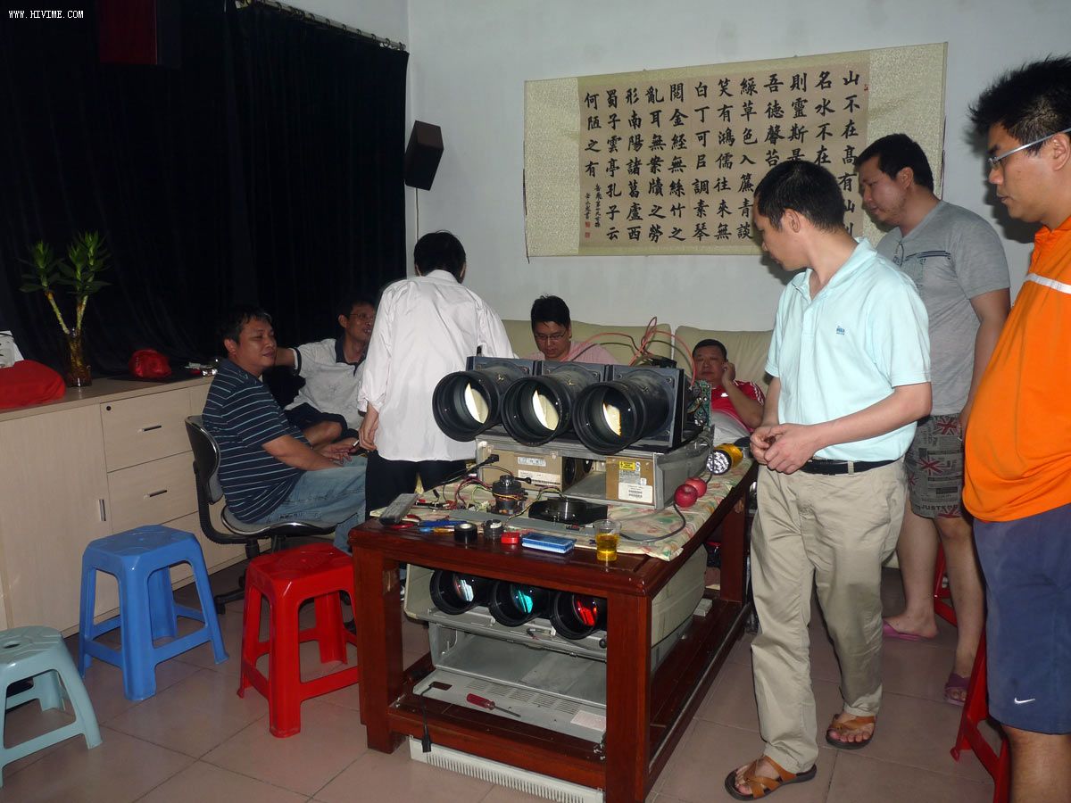

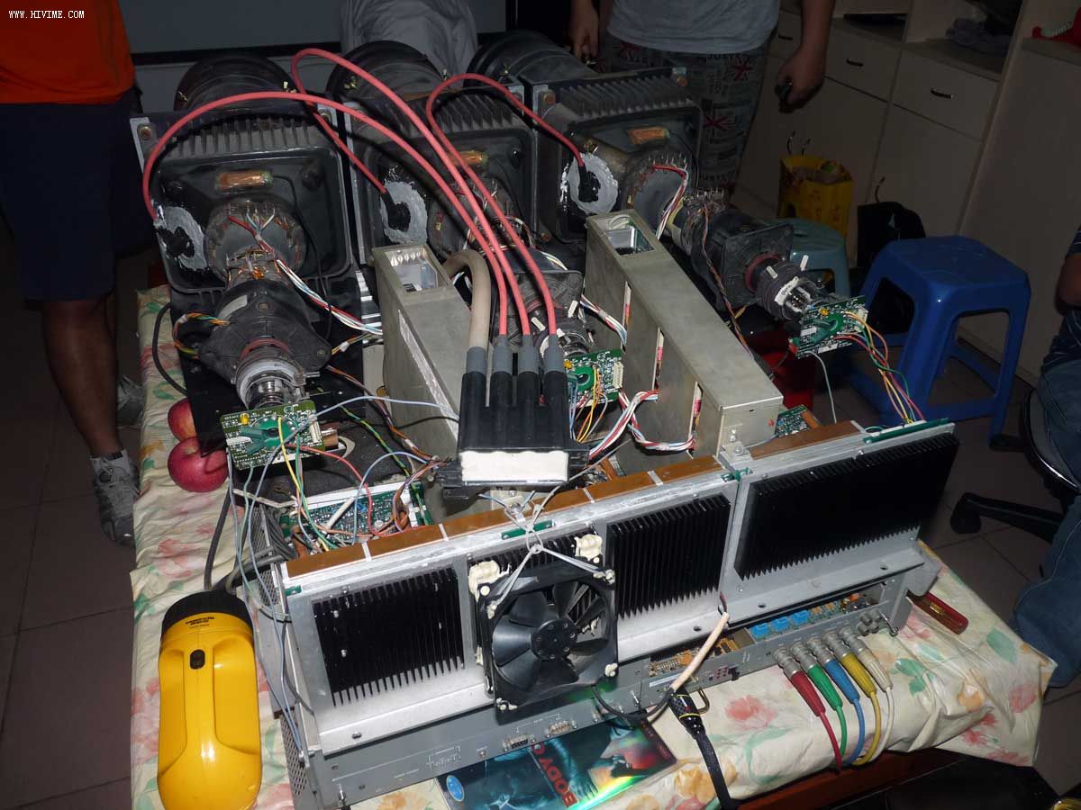

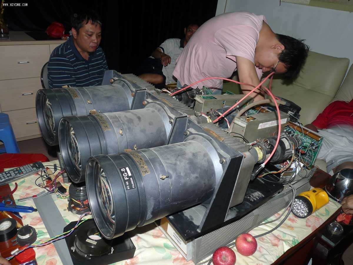

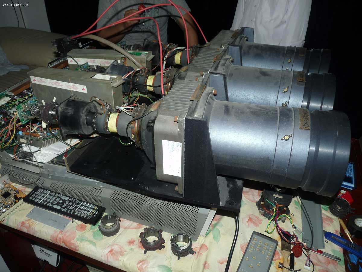

Chassics and circuit board are come from marquee 8000.
Tubes are Toshiba e8514 from IKEGAMI TPP1600.
The splice PJ is in China,canton

George your one crazy Son of a bitch!!! I love it!!!
How the hell did you connect the marquee VNB to the toshiba Video Amps?

The splice PJ is not my work.
And by the way,those Toshiba e8514 are 9" tubes.

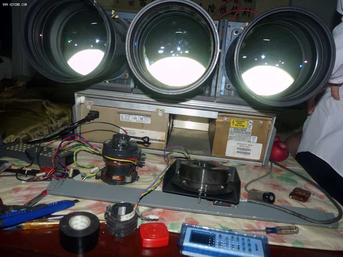

Great work. What sort of image does this throw. Never used Toshiba tubes in any PJ.

Nice! I wonder how good are those lenses? Ikegami had TV-cameras (probably with their own optics) back then..
Edit. Just looked closer, at first picture ,there is label :Fujinon. Probably those are good lenses?
DVDO VP-50
New hobby, Rally
Posted: Wed May 04, 2011 4:48 pm    Post subject:
The "sony" lenses were also made by fujinon.

Posted: Sun May 08, 2011 11:43 am    Post subject: Specs ?
That looks awesome, so whats the specs, throw, resolution, etc?

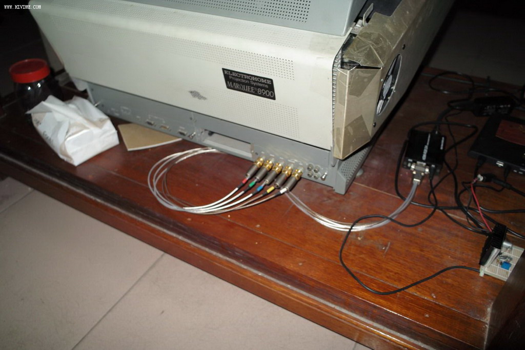

The splice's owner try to put these tubes into a marquee 8500.

did the pcb`s at the end of the toshiba tubes come with the tubes or did you make them so they now are an adapter for the marquee neckboards?
did you use all marquee magnetics on that toshiba tube?

Posted: Sun May 15, 2011 11:28 am    Post subject:
G90 XG circuit is entirely possible to use, XG pressure changes . Change rear projection tube wiring board Change the focus and the convergence coil connection

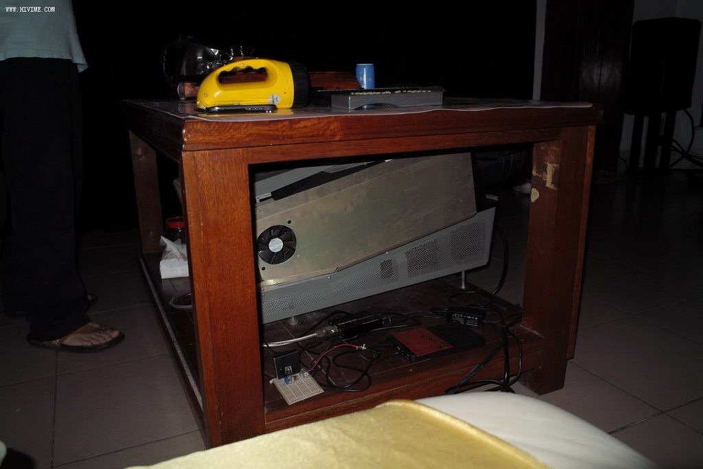

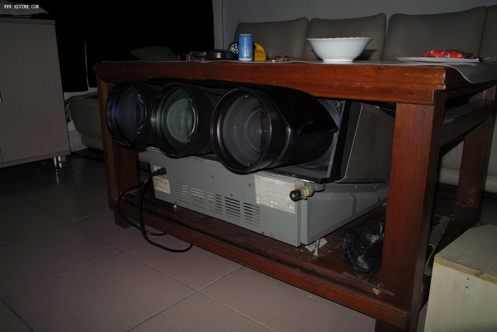

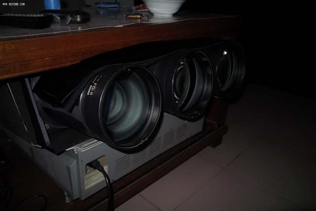

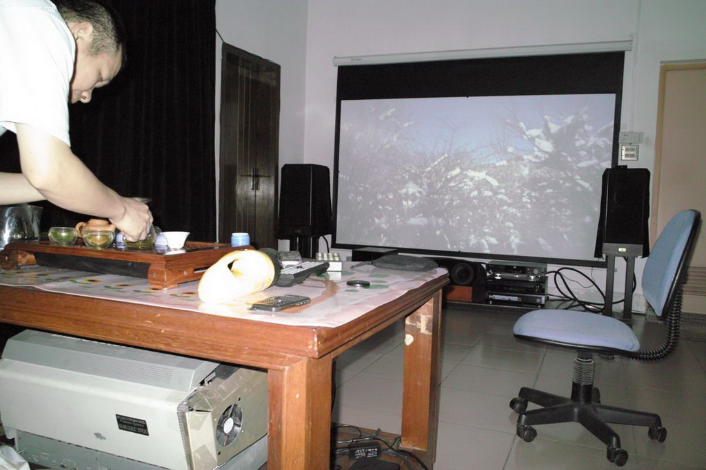

The final results

Posted: Fri Aug 12, 2011 1:43 pm    Post subject:
That looks nice. You might want to put some carpet down on that shiny floor.
HaydnG90
Joined: 22 May 2006
Posts: 1356
Posted: Fri Aug 12, 2011 2:32 pm    Post subject:
Exactly what I was thinking. Spend hours setting up that beast and then a slight tap with the knee and its all for nought. Instead of carpet which isn;t so practical in that climate, I'd glue some rubber to the tile and something abrasive at the bottom of the stand legs.
