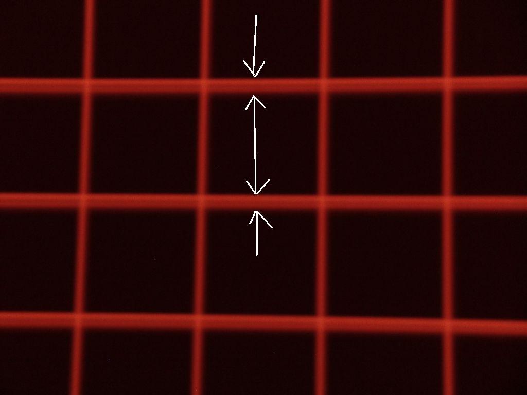

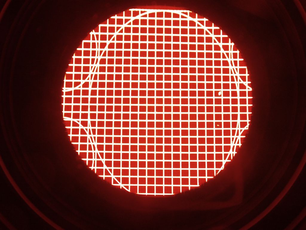

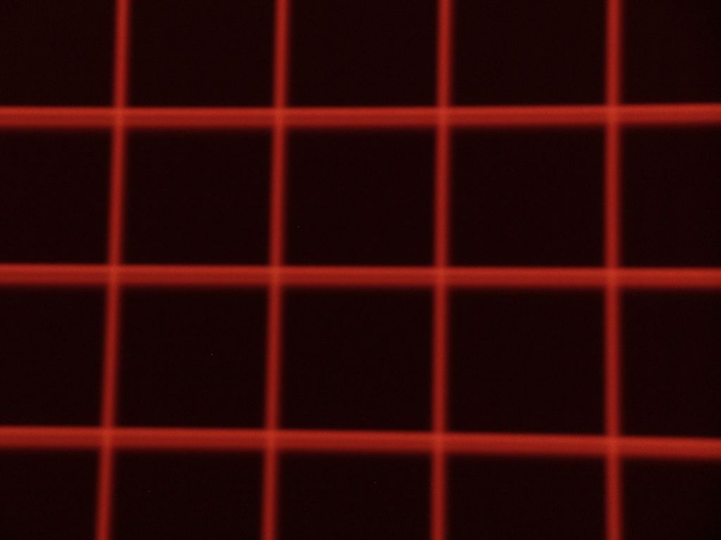

One is of the tube face the other the screen, both taken from the red obviously but all three tubes are the same. You can see the lines are thicker going up the tube face, or it looks that way to me.

Posted: Thu Apr 28, 2011 4:12 pm    Post subject:
I'm not seeing it, they all look the same?

The thick lines at the top photo? I could not get the camera to take a shot of the thinner lines above them for comparison sorry.

Posted: Thu Apr 28, 2011 7:18 pm    Post subject:
are you refering to this ghosted double image?

if that's the issue then that would be sometihng in the vertical sweep. Try reversing the V and see if the ghost image goes to the top of the solid line, page 131
