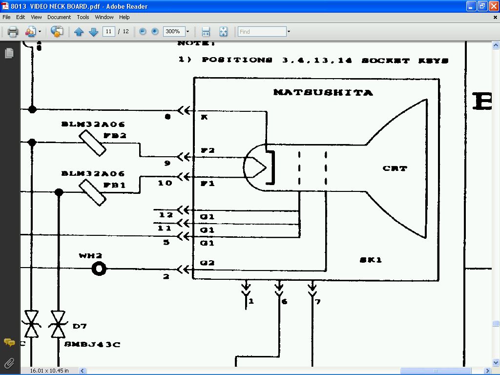

Here's the 8000 neck board. Will that work for you or were they different?
 Filesize:  97.66 KB
 Viewed:  2116 Time(s)
Posted: Wed Apr 13, 2011 11:20 pm    Post subject:
Sorry Mac
The Thomsons were unique, nothing like the MECs.

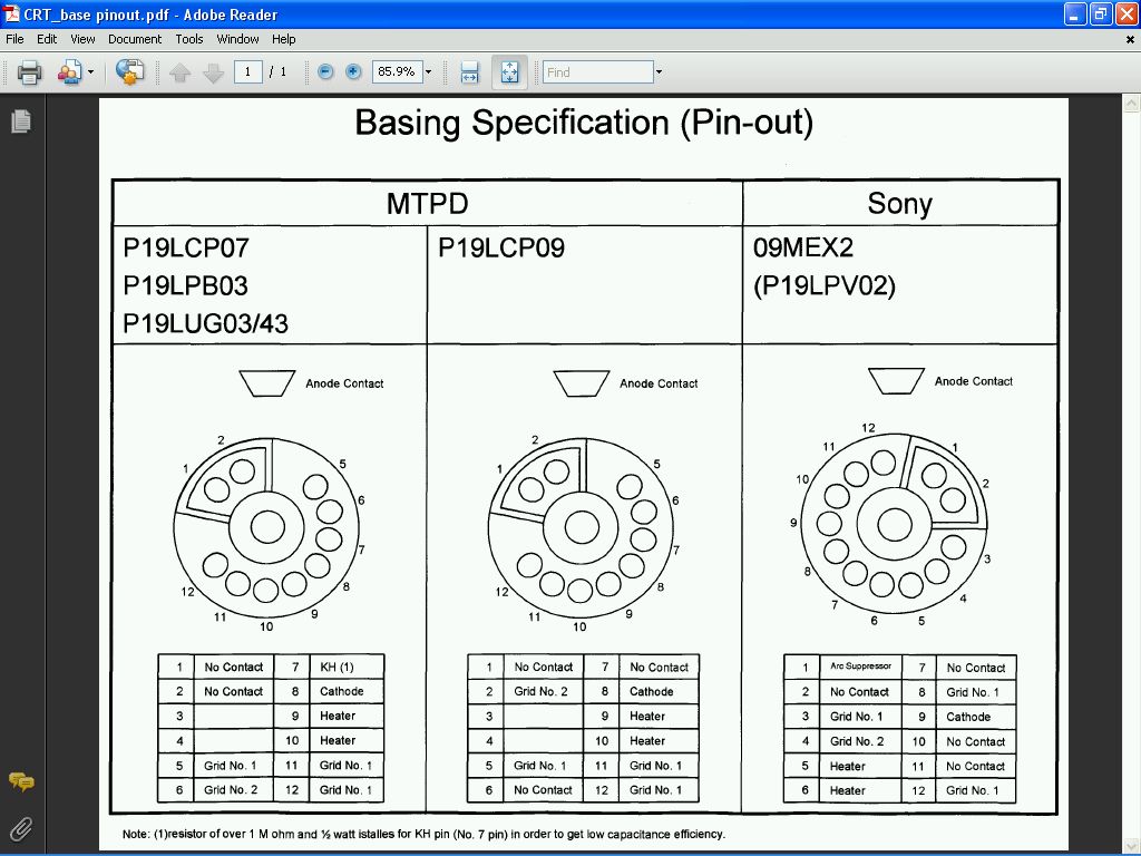

Posted: Wed Apr 13, 2011 11:42 pm    Post subject:
Weren't they like the Sony MEX?
 Filesize:  120.5 KB
 Viewed:  2102 Time(s)
Posted: Wed Apr 13, 2011 11:43 pm    Post subject:
Never mind, that was the thomas i believe.
