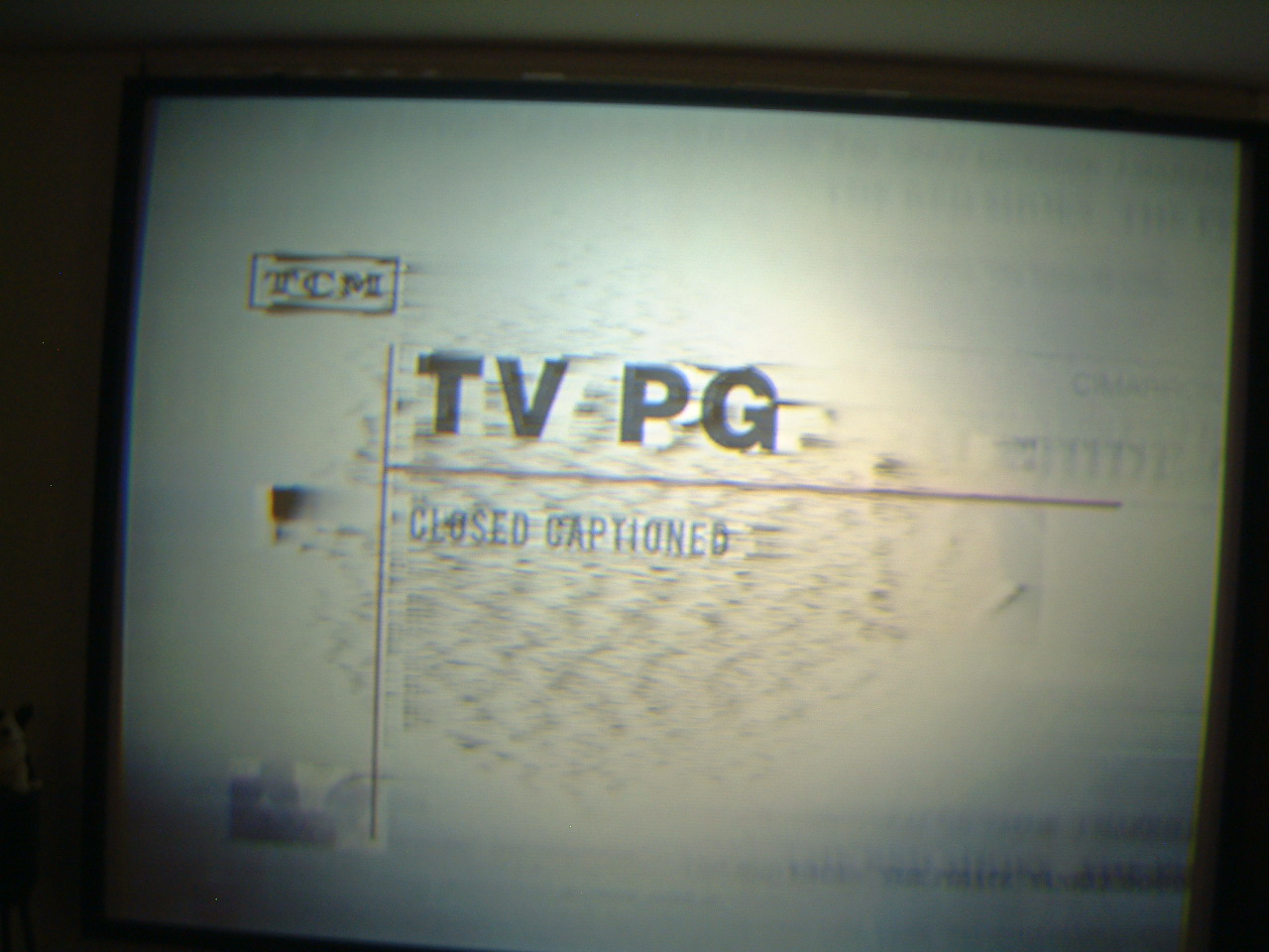

This is a picture of the problem- as posted earlier,I have a Barco 701s and over the last 8 months picture has issues-black and white "bleed" into each other, rest of screen colors okay.
You can see the black and white mottled effect . When watching the black and white areas "bleed" back and forth.
So far it seems about 50/50 in terms of repair versus new purchase.

You're talking about the area in the middle of the screen, right? I have never seen that before on a BArco 70X series, but I have an idea. This might be drifting of the 17 volt test point on the SMPS board. Pull out the SMPS board, find the +17 volt adjustment pot, and fire the set up with the SMPS pulled out (hoping it's floor mounted, you can't do this with the set on the ceiling).
SLIGHTLY rotate the SMPS trimpot back and forth and see if it goes away.
If that doesn't work, then I'm baffled. What input signal are you running to the set, are you sure the source is OK?

well first off S-video 480i is almost the worst signal you could send to the machine. I'm not a Barco expert, and Curt would know better here, but first thing that comes ot mind is some kind of possible issue with the composite video processing. Before you tear it down I would try running 480P progressive scan to the set through component video. Your going to need a compnent video cable with RCA on one end for the DVD player and either BNC connectores on the other or RCA/BNC adapters which I think you can get at rat shack. Disconnect the S-video, run the Component, and you'll need to switch iunputs. I think component video is inpout number #5?
Posted: Tue Apr 19, 2011 3:41 pm    Post subject:
It might be worth a try to take the component output of a DVD or HD box and feed it into the RGB inputs of the set, then select input '6' I think. You'd only be out the cost of three RCA to BNC adapters, about $6.00.
The difference in picture quality will be stunning over the Svideo input.
If that's not it, and you're not willing to pull out boards and send them in, then you're better off with a digital projector frankly. I don't think you'll find anyone working on Barcos in Chicago unless a forum member comes forward to assist.
