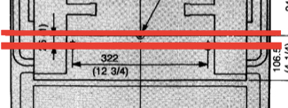

the underside of my projector looks exatctly like the one in the pdf, but i don't understand how you are going to mount two pieces of tubing to it.
Edit:
is the way you are suggesting i mount it, similar to the picture with the red bars?

Posted: Fri Apr 01, 2011 7:47 pm    Post subject:
Had to post the picture in another post?
