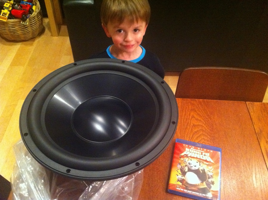

I modeled a a whole slew of drivers from many different sources and finally settled on the Dayton Audio RSS390HF-4 15" Reference HF. It was on sale from Parts Express for $159. It doesn't have a huge Xmax (14mm), so no giant power-handling/output numbers like some subs, but for the price, I couldn't find anything that came remotely close to the LF extension.

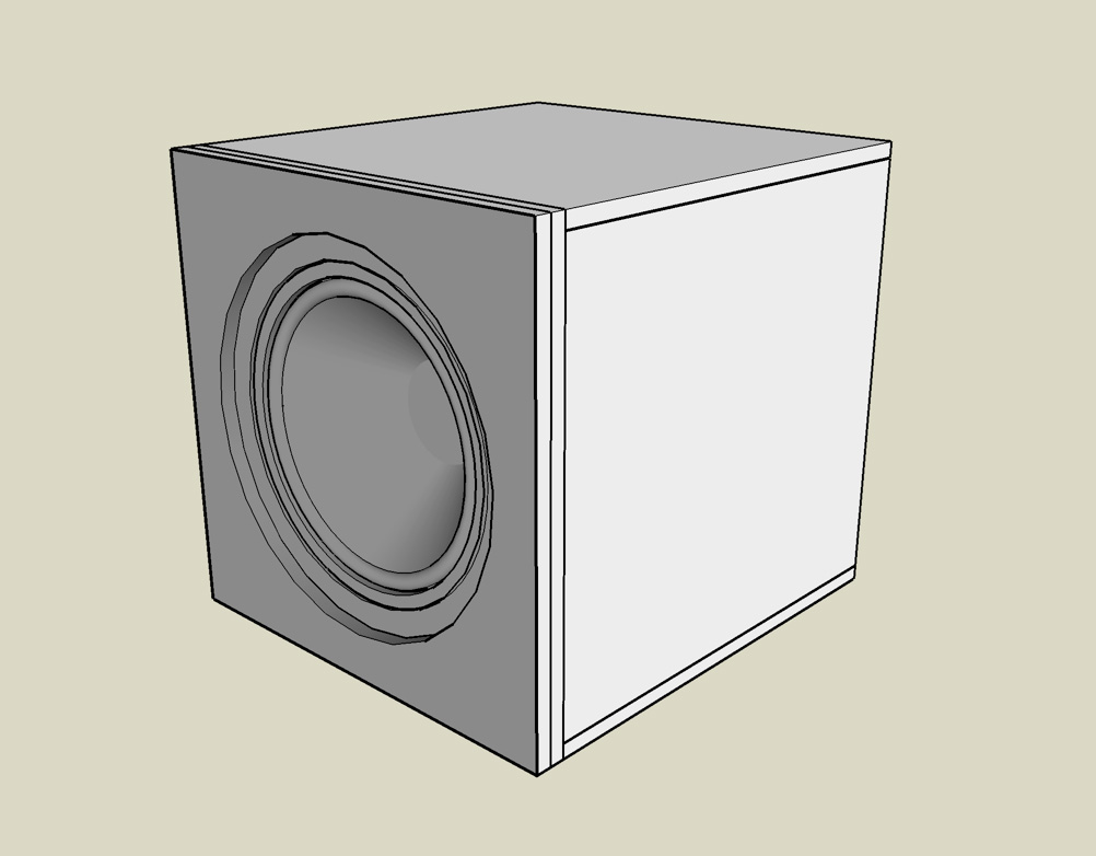

So, with a little help from Darren, I settled on a box a little smaller than five cu ft. That's huge, right? It works out to a 20.33 in internal volume, not including amp, driver, or bracing. But, I've got a dedicated room, no WAF issues, so after considering all the issues and using 3/4" MDF, the box worked out to about 22.5" on a side.
For an amp, I wanted a plate amp. I don't have anything but line-level wiring to the front of the room, and I didn't want another amp with a fan. To that end, I chose to use the O-Audio 500w BASH amp from O-Audio for $239 shipped. I considered the PE 500w BASH amp for about $50 less, but I did some reading and the PE amp has a 30hz HP filter that requires modification for use in a sealed cabinet. Conversely, the O-Audio amp has a selectable HP filter, but also has a single-band parametric EQ for adding LF boost.
So, according to the modeling, the sub will be down 3dB at around 25hz… Doesn't sound great, but with the driver, enclosure and amp, and a target output of only around 105dB to integrate with my mains with plenty of headroom on all but the most wicked demo sessions (Twisted Evil ), I should be able to EQ the pair of them flat to about 15hz in-room. THAT is what I'm going for. Oh yeah, I'm building two of these. Headroom, baby!

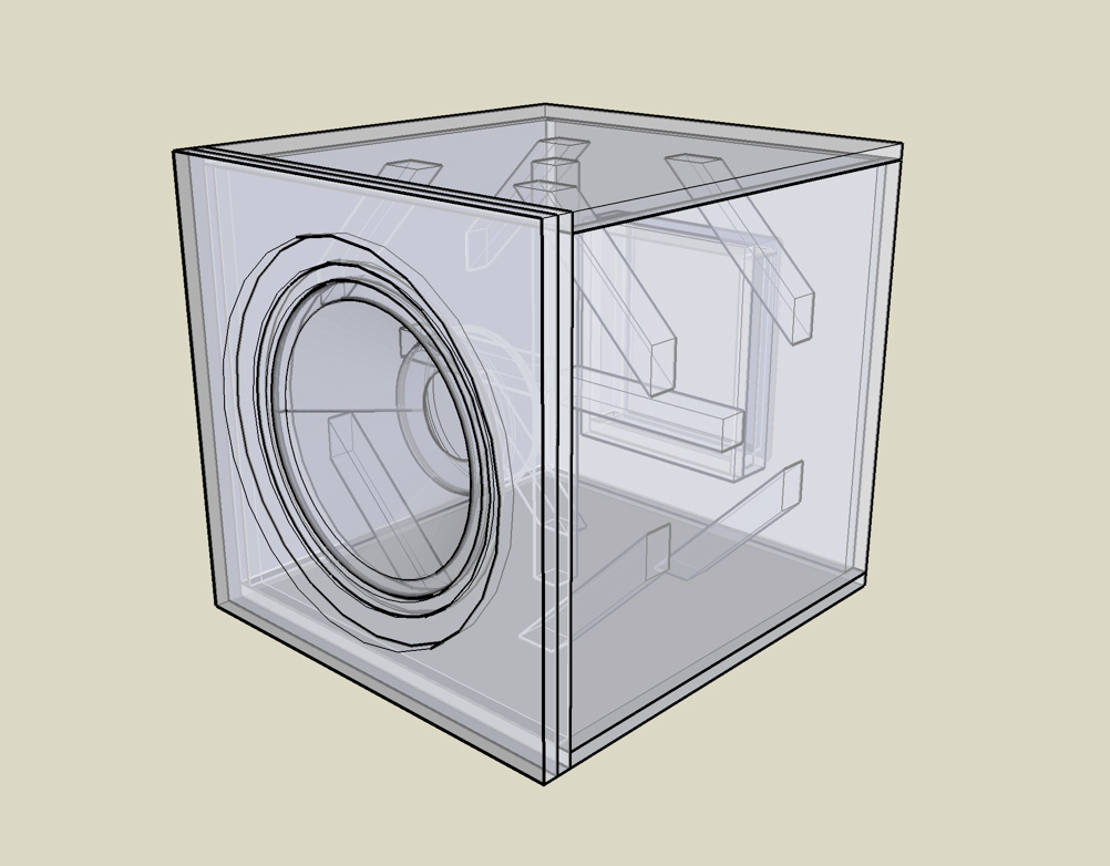

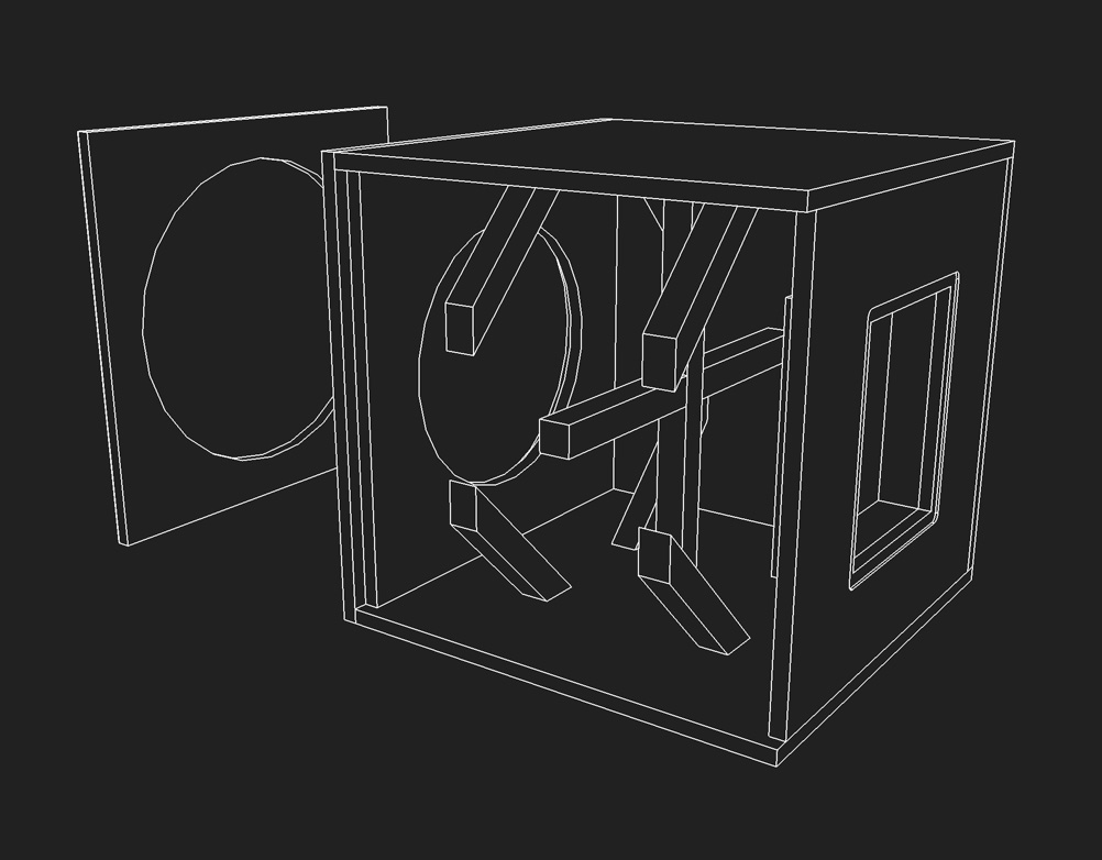

Here's the rough design in SketchUp...

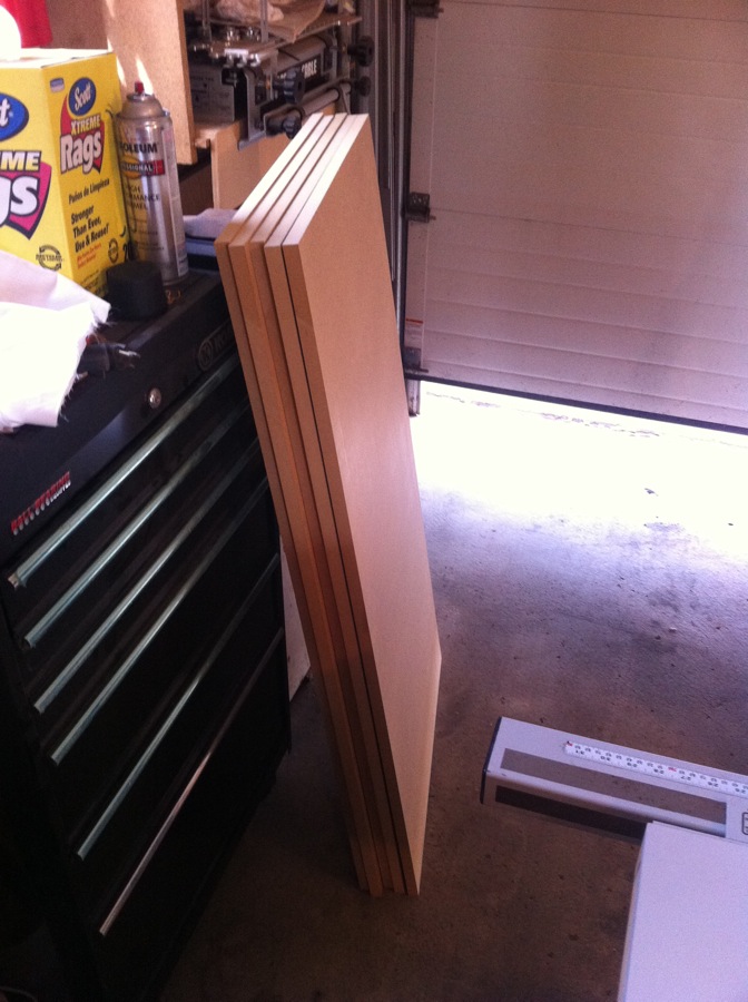

Stack 'o MDF from Home Depot...

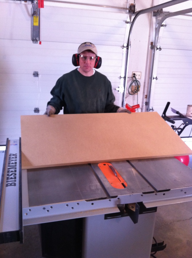

My buddy Chad getting ready to feed the first sheet through his cabinet saw...

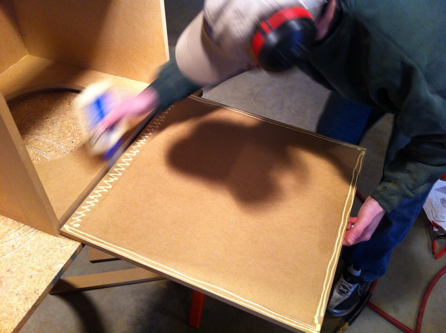

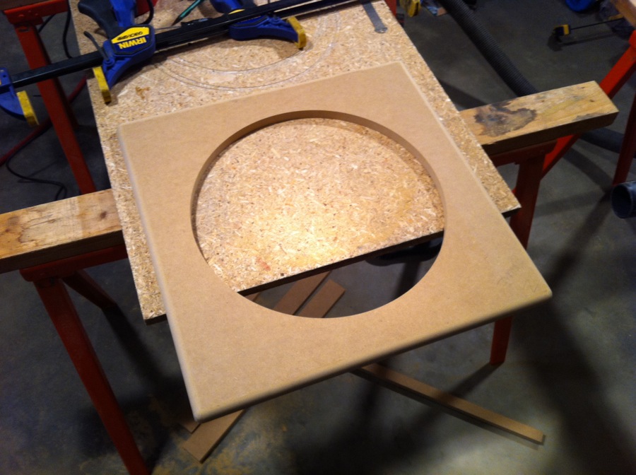

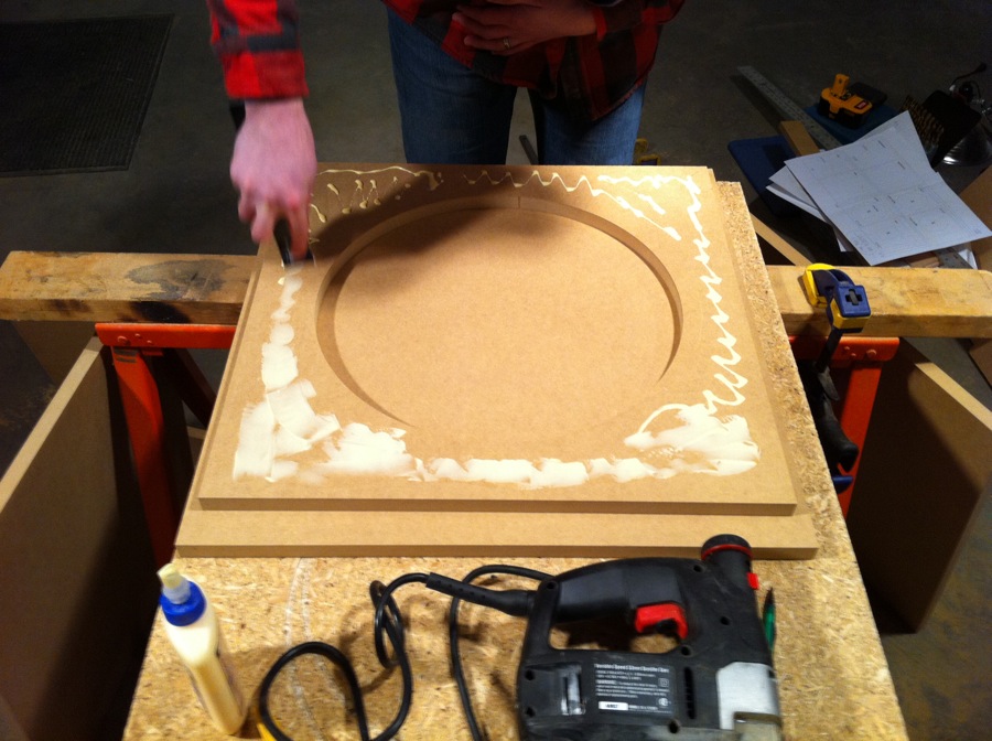

Gluing the front double-thick baffle...

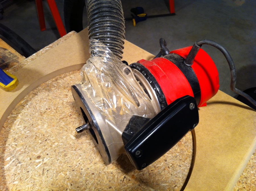

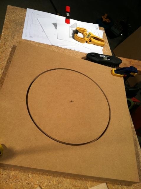

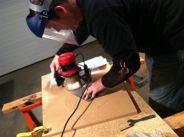

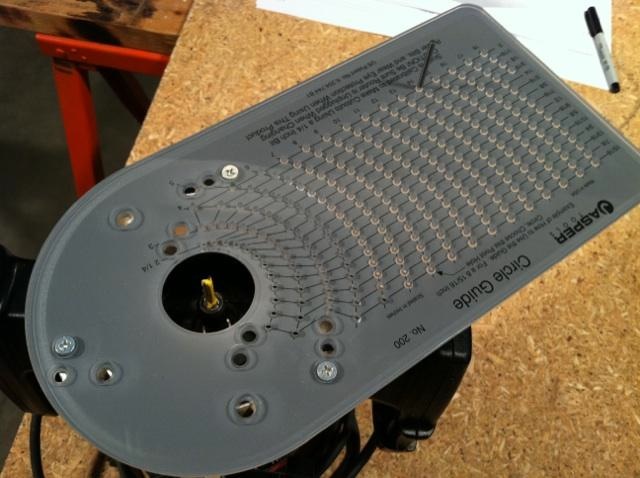

Jasper Jig circle cutter on the router...
Cutting the baffle...
Baffle cut with the Jasper Jig...

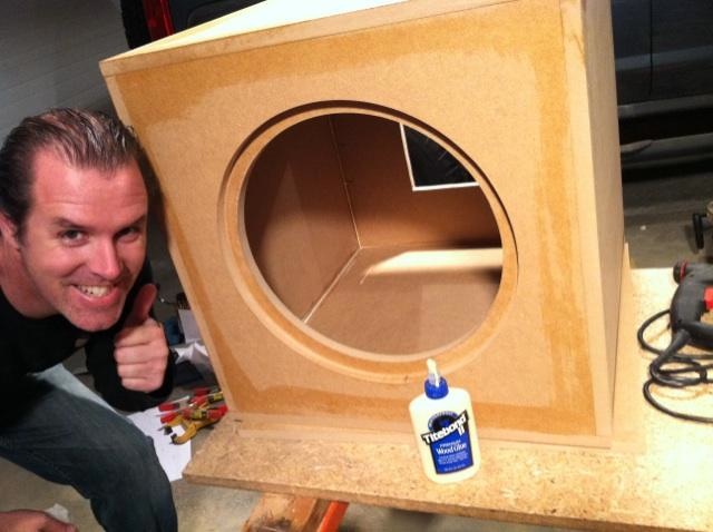

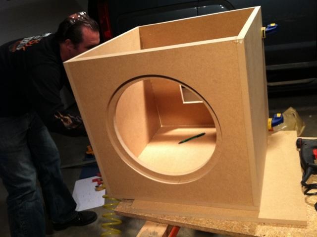

There's one mostly built...
Awwwwww yeeeeaaaah....

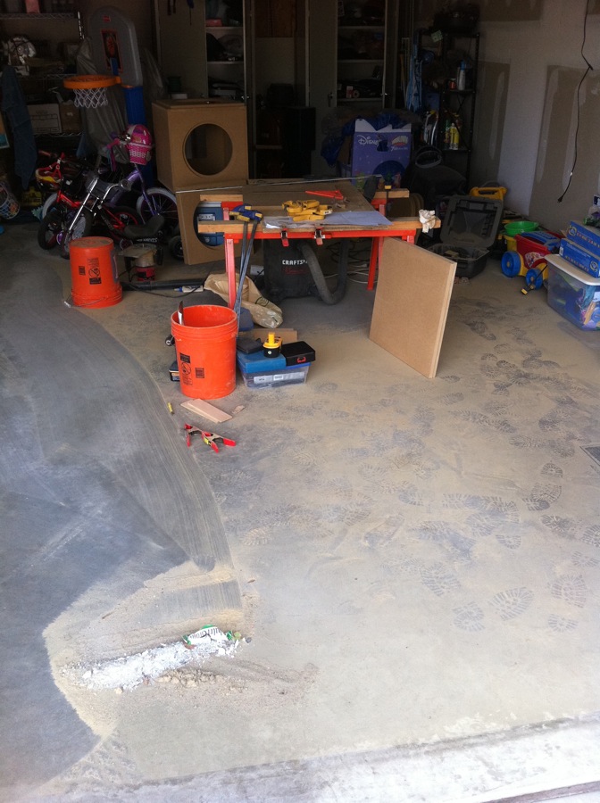

What happens when you use a router with a cutting bit and no dust collection. Yikes!
Gluing up #2...

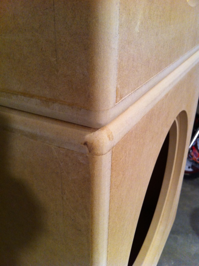

Routed the grille frame with a 1/2" roundover...
Trailer park dust collection system... Worked!!!

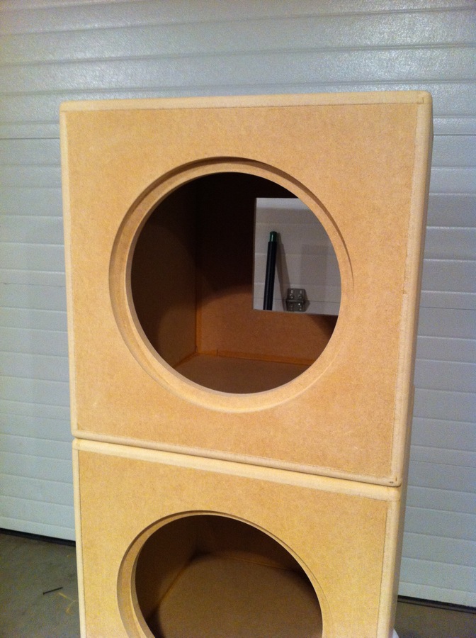

Stack 'o subs!!!
Routed corner detail before any sanding or filling!!!

Wouldn't a sweet cabinet table saw be nice?! I have a 30 Sears table saw without adequate table space but I make due.

Chad's saw is amazing. Holy crap that thing was accurate... Every piece was EXACTLY square, clean, and smooth. You could almost cut your finger on the edges of those cuts! In fact, the saw cuts were almost as smooth as the router cuts I made. And man that thing was quiet!

Nice work...Tell us more about that saw? I googled the "Biesemeyer" but didn't get much other than a rip fence or something.

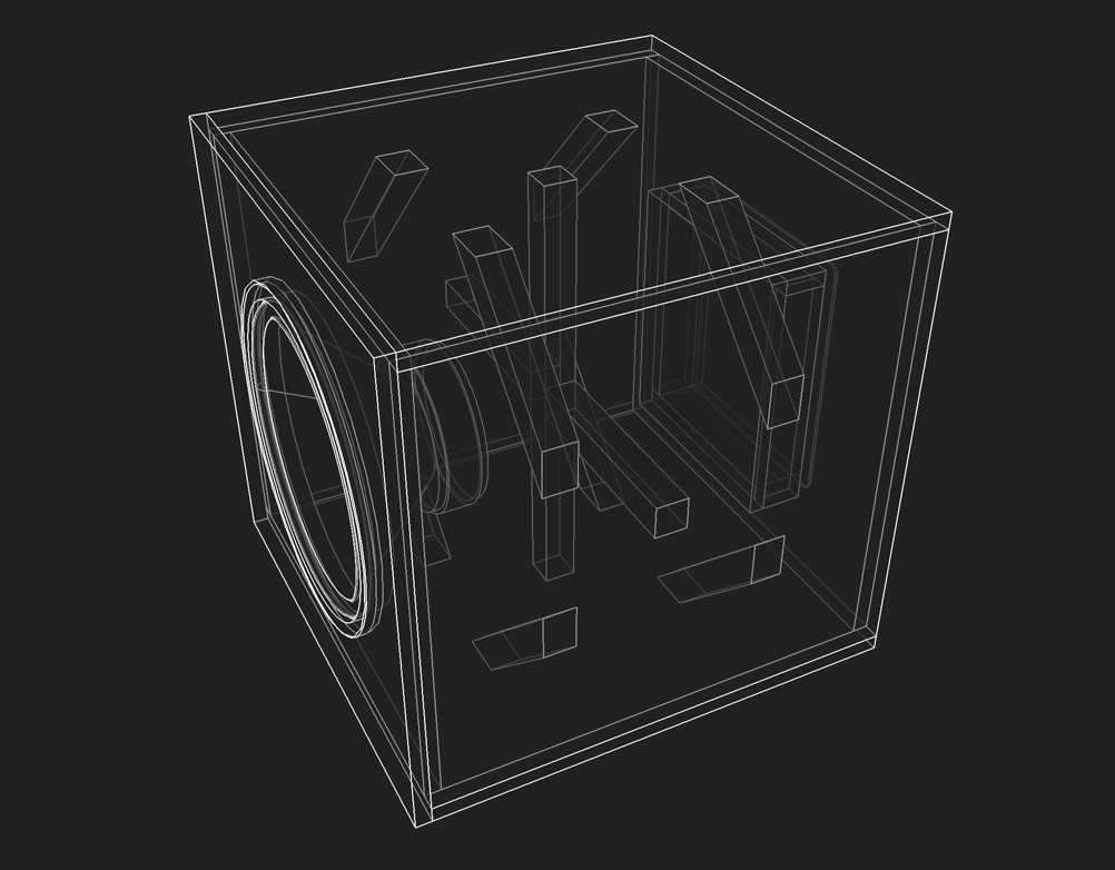

Also in the wire frame of your design I see gussets inside the box...Are those still in the plan?

Its basically an insanely nice table saw, right?
Think thousands of dollars.
http://www.rockler.com/c/cabinet-saws.cfm

Yeah, like Greg said... Pretty much just an expensive table saw. Compared to a typical table saw, the motor is bigger for smoother, more consistent cuts, the bearings are better for better blade control, and the table and fence are bigger for more cutting larger pieces more easily and accurately.
My buddy also added the Biesemeyer fence system to his, which gives you this awesome super-accurate fence... It slides and locks, is über square and über-accurate. When he set the fence to 21", the piece came out EXACTLY 21". The proof was in how easily the box went together. None of the joints were off by more than a 1/32", and most were less or even dead-on.
Yep, I just haven't gotten to the bracing, yet. I just picked up the 2x2's from Home Depot last night. Hoping to get them cut and glued and nailed in on Thursday afternoon.

Biesemeyer is just the fence, the saw looks like a Delta Unisaw or equivalent. They're nice saws and will cover pretty much any needs in a home shop and will hold their own in a commercial shop doing lighter work. We have a Powermatic 66 in our shop (basically a Unisaw equivalent) and it's leaps and bounds better than the contractor saw we had before due to the higher power and much larger cast table.
They're very nice solid saws but I'm not sure "high end" would be a descriptor I would use, to me that conjures up images of some of the even more expensive sliding table machines made in Europe.
