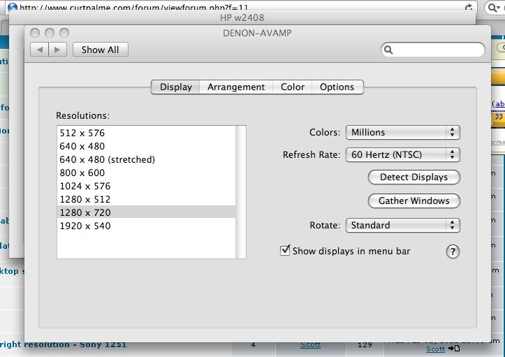

I am interested in the future to try 1080i with my ECP, right now 720p is looks just fine... but I like to use my mac (plugged into my Denon A/V receiver with HDMI switching) I like to use Front Row so i can watch video files on my HD. It doesn't seem to have 1080i.. it has this odd resolution 1920x540.

1920x540 is similar to 1080i It is what Crag rounds actualy set up from my lumagen to my Mitsubishi RPCRT which is only 1080i Capable.
But you can download SwitchResx http://www.madrau.com/indexSRX4.html
It can creat custom res on your mac, its pretty cool.

wow sweet! i didn't know there was an app like that for mac.. thanks Athanasios! the dual G5 actually does a pretty good job at doing HD videos. would like to get a 1020 Box or whatever its called so i can fix the annoying raster shift. love the mac colorsync.. i can do gamma boost and everything...

here is a good thread on SRX on AVS
http://www.avsforum.com/avs-vb/showthread.php?t=751713

ahhh interesting thanks a bunch... i played around with it, couldn't get the display resolution to show up. Perhaps it would help if i plugged the mac directly to the HD Fury instead of going through the AV receiver. Once i have a resolution that works connect back up to the receiver for HDMI switching?
