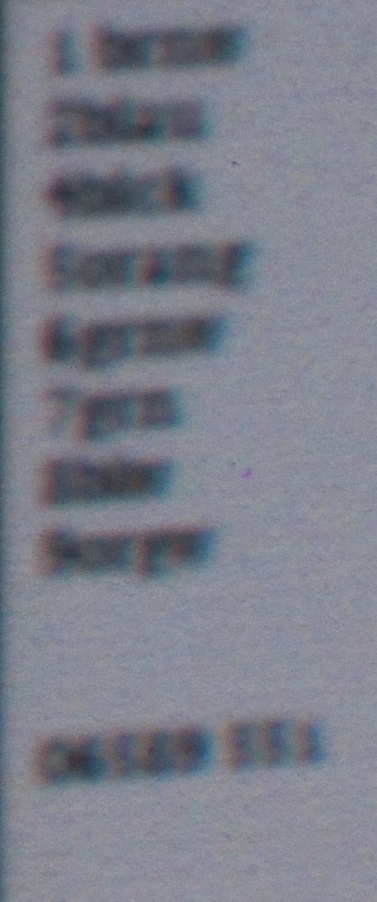

Screenshot with textsize 5 in the middle of the picture, you can see the scanlines (i juse 1080i at 75Hz)

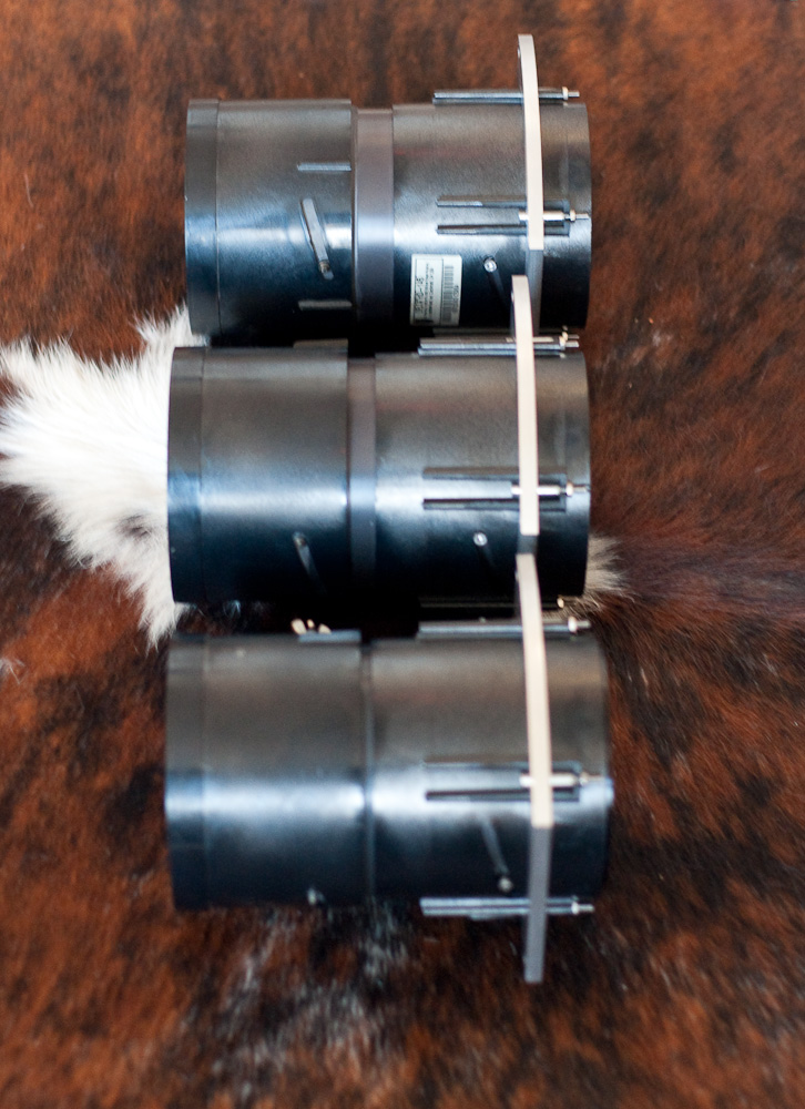

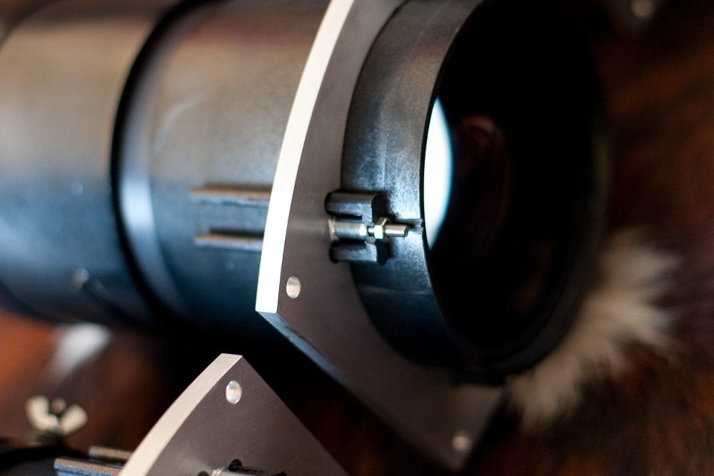

Lensmount detail

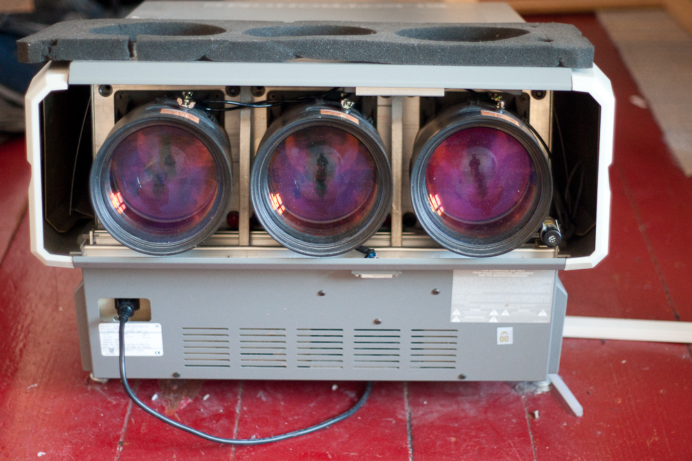

PJ before Modification (sorry i got no Fotos afterwards, but the look is not as monsterous than before)
Lensmount

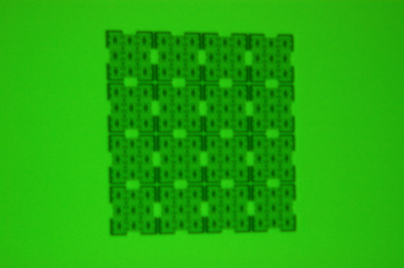

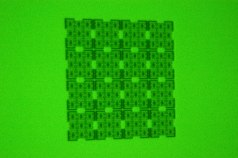

I think one year ago, i got the HD8revBs and those PT65 lenses from my Sony 1271.
I tested both of the lenses and noticed a slightly difference. According to the following link, i choose the PTs and sold the HD8s for 1€ (shame on me).
http://72.9.159.100/avs-vb/showthread.php?p=9655410
Because i got the fear that the old post on AVS got lost, i uploded the pics again.
They were taken on a Barco Graphics 1208s/2.

Revox
Joined: 13 Feb 2008
Posts: 158
Posted: Tue Feb 01, 2011 8:51 pm    Post subject:
I don't know the guy who made these fotos, but according to these the PT 65 are much sharper (notice the picture names).
