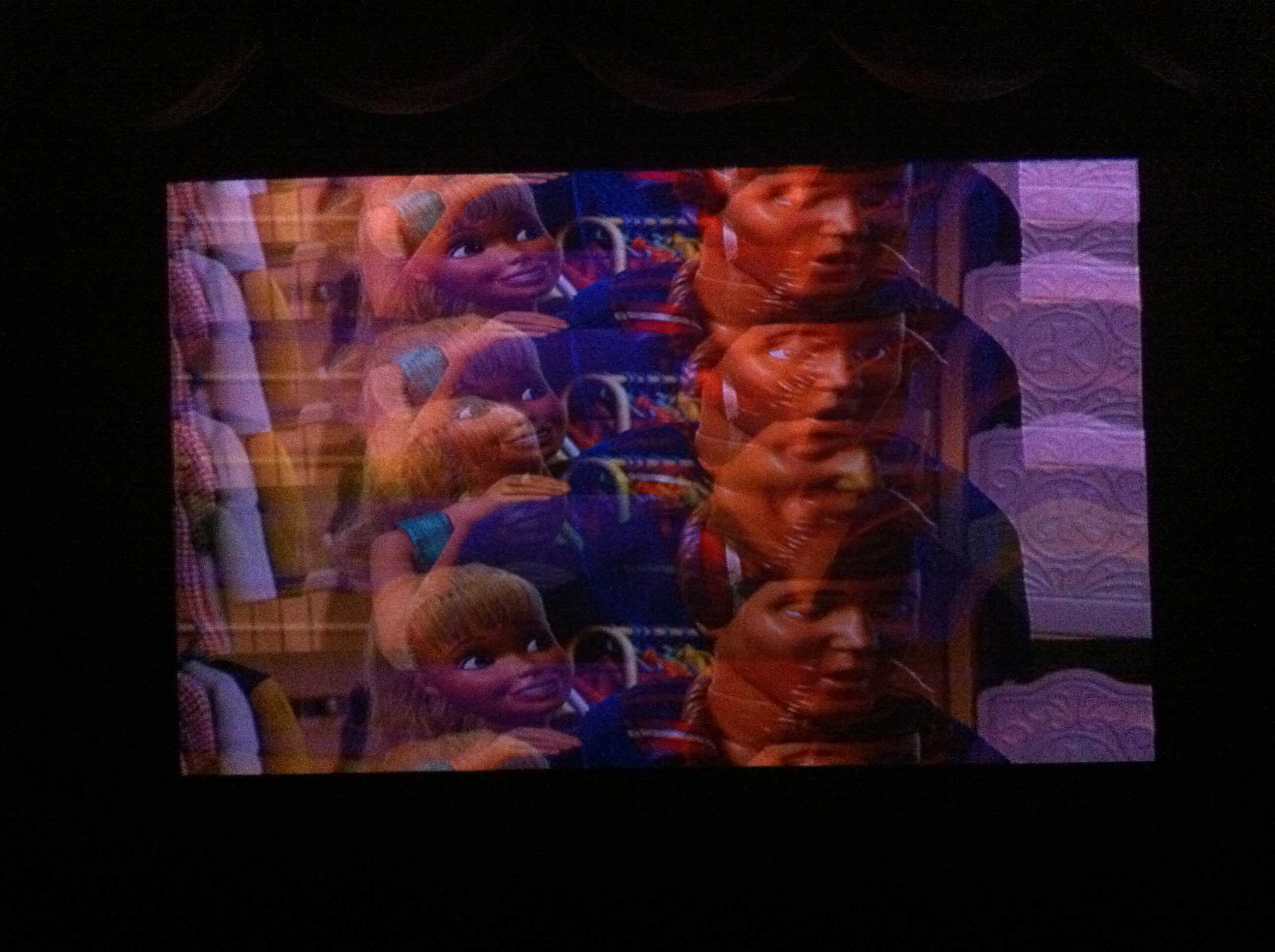

I am really hoping someone can help me because this problem is seriously doing my head in. I recently decided I wanted to upgrade my home theatre to support 3D so I have purchased the Moome EXT-FULLHD V3 3D card to use on my Sony G70 Projector that is connected to my blu - ray HTPC. I don't really know all the technical terms but I will do my best to explain the problem.
I connected the Moome card to the projector using a VGA to 5BNC cable and the HTPC to the Moome card using a HDMI 1.4 cable. The problem I am having is I can't get a stable picture, the image is there but it spins or pans (not sure of the correct term) on the screen I have my G70 set to:
5BNC off
Input A - HDTV-GRB
Sync - [HV]
Sync OSC - 1
Though I have tried every different setting I could think of on the G70 and nothing seems to help, I have also tried playing with the DIP switches on the Moome with no luck. I thought is may be a problem with my HTPC so I formated the hard drive and re-installed windows 7 from scratch, then I tested every resolution and Hz possible and still the same problem persists.
PLEASE HELP.... I have read so many forums but can't seem to find anything that relates, I wish someone had written a guide for Moome on the G70, that would be a great help.
Any advice would be greatly appreciated.

Hmm... I have a 1292 with EXT V3 working fine, there shouldn't be a problem there with a G70.
Can u post a picture and the actual settings of the box? From what u describe it could be a sync problem...

Ok so I can rule out the HTPC from being the cause of the problem as I just connected my Sony 3D Blu-Ray player and it is doing the exact same thing. I have attached a picture to show exactly what is happening. All 5 DIP switches on the Moome box are in the down position but I am sure I have tried them in every possible position. I am getting so frustrated because connecting it all together was meant to be the easy part, I was expecting the 3D settings to be the difficult part. I have been playing around with it for 2 days now and I really don't have a clue what else to try, I wonder if the Moome card is damaged?

Sorry forgot the attachment.

Finally I have managed to get a stable picture, I needed to open the moome card and change one of the pins inside to get it to work, would have been nice if it was simply plug and play instead of all this wasted time of stress and frustration. I can get a stable picture but it still has the same problem when I try 3D, the screen goes crazy again.

as I said this was a sync issue Smile For 3D playback u need to set your display to 720p@120Hz, a list of the allowed resolutions u can find in the ETX V3 manual (Other resolutions than those described in the manual will not work for 3D). If picture is too dark check if u have activated black boost function (dip switch 1), also check gamma, contrast (screw beside VGA connector). What soft player do u use?
