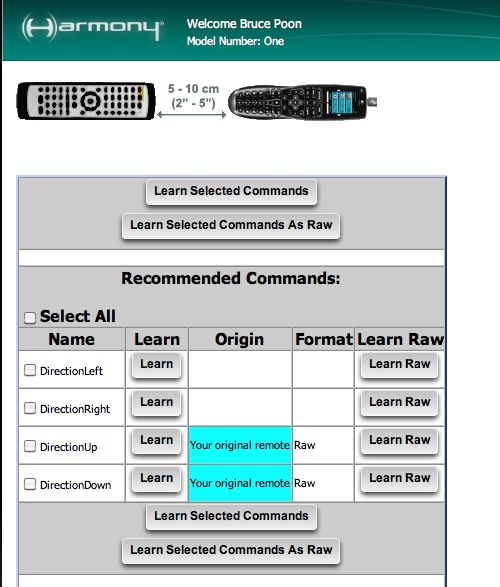

Thanks! Got it working thanks to you. But just to elaborate, in order to program in the "raw", you have to go into the "Learn IR" under the device, and then click on the "Custom" button at the bottom. After that, for each of the command in the list above the button, there will be a button called "Learn Raw". Just click on that and follow the instruction.
