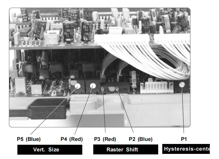

Hello
It’s me again. I`m starting to feel a bit goofy with my questions but this forum is a great resource of knowledge.

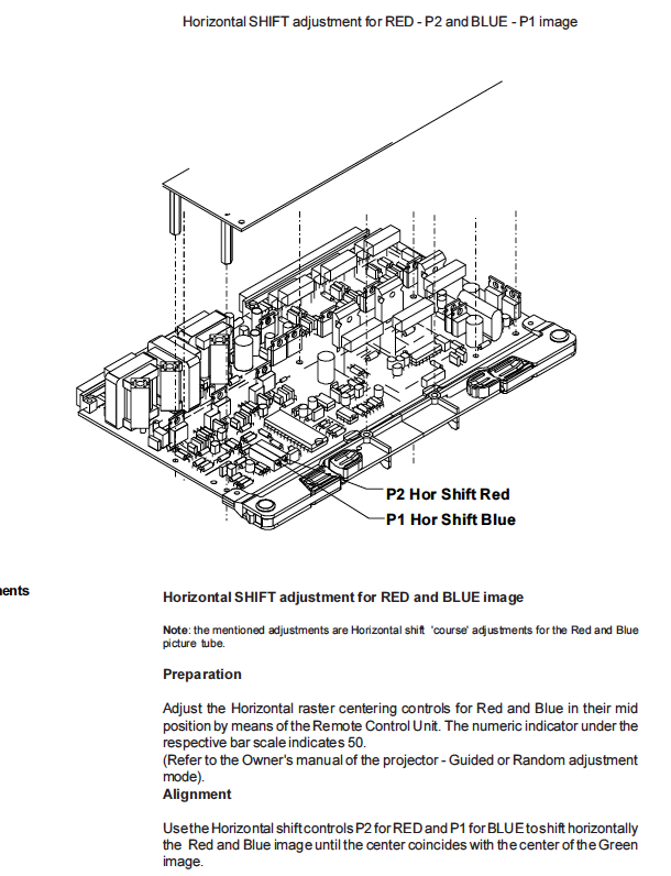

I managed to set up the green tube to a good position but when I look in to the red and blue tube they are way off to the left and it couldn`t be fixed with the raser shift. I would like to know if there is a way to manually way to move the raster of the red and blue tube? It took me a long time to set up the green tube and I would rather not start to mess with it again.
Best regards.
papegoja
Joined: 08 Jul 2008
Posts: 19
Posted: Thu Jan 20, 2011 8:51 pm    Post subject:
On Vertical Deflection board U can raster shift vertically.

And on the Horizontal shift there are also two pots to adjust.
