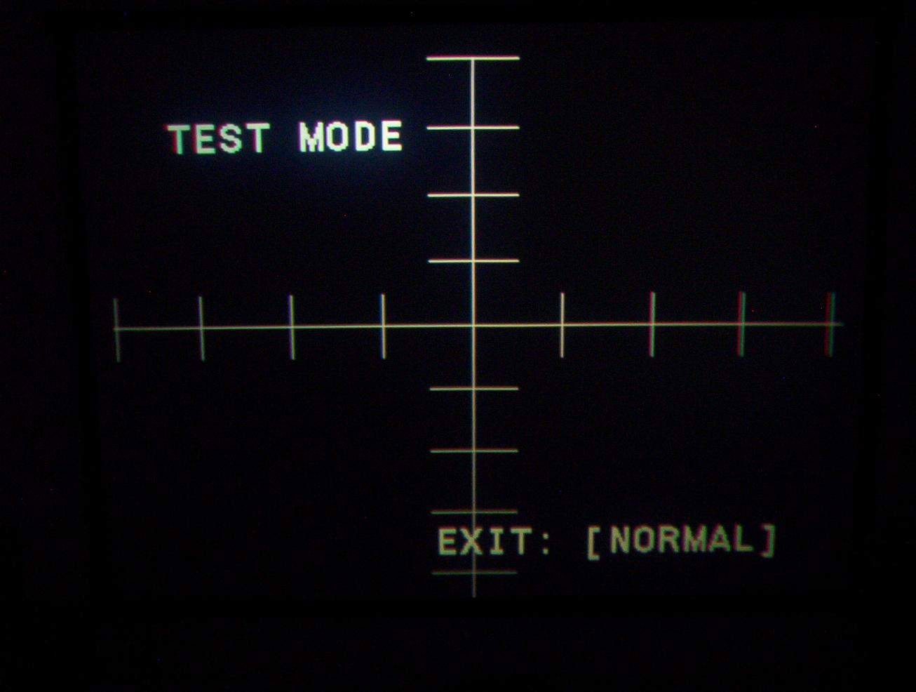

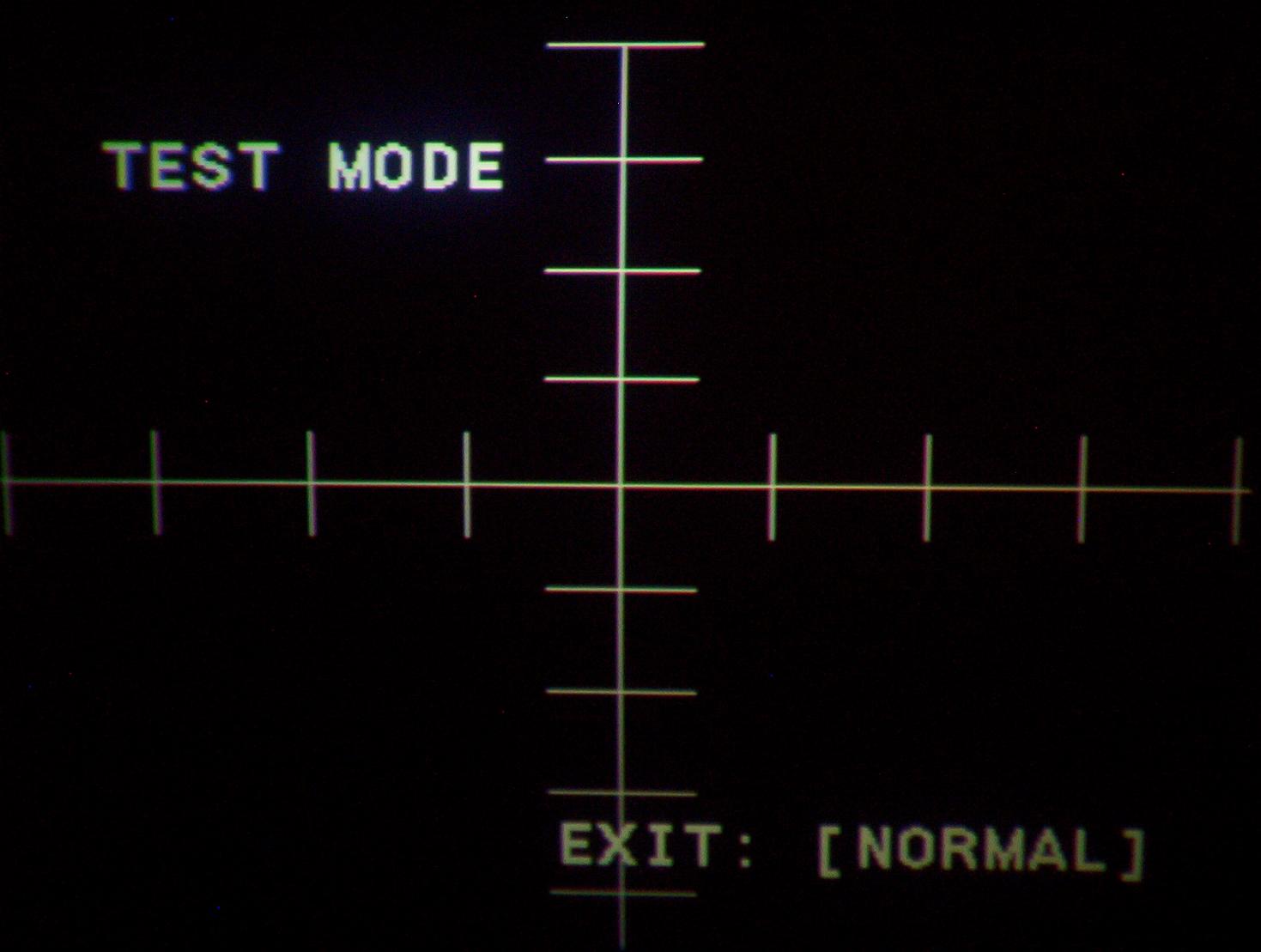

Posted: Sat Jan 15, 2011 11:42 pm    Post subject: Here are the pictures
Okay,
I was finally able to get a picture when the projector is behaving normally. Here are pictures of it when it is deconverging around the right third of the screen, as well as a little on the left, and when it is normal. I have labeled each. I hope this is what is needed to determine the problem. Any further suggestions I will be happy to do.
Thanks.

Posted: Sat Jan 15, 2011 11:48 pm    Post subject:
Do you have the projector square to the screen?

Posted: Sun Jan 16, 2011 12:03 am    Post subject:
So, when you throw up the crosshatch, is it that red pattern is just getting smaller than the other two?

Posted: Sun Jan 16, 2011 12:15 am    Post subject:
Yes, but only on the right side of the crosshatch. It starts to happen slightly on the left side sometimes, but that usually corrects itself. The right side will correct itself as well, once in a while, and everything looks normal again.
