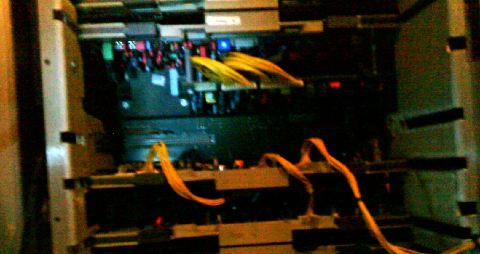

I got the cable from blue jean and sent them this http://www.curtpalme.com/Barco_Port3_Input.shtm so they wired it after that. I have dealt with blue jean before and know that they have really good quality products so I don’t think there`s any issues with the cable. Actually I found out that there is a card missing from the card slot somewhere in the middle. I’ll try to attach an image.
If that’s the port 3 card then I’m going to need one so I will contact Mr Palme for sending details. One question though I have an old BD 808 in my basement and maybe there is a port card there, if so is it compatible with the 1209?

Port3 card seem to be missing.
808 use same R7621055 card, it's that only one with one mother board connector.
You have to connect also that yellow wire to switcher board J3 connector, it's that only empty one...

As Ile told you, you definitely not have port3 card installed. Use one coming from BD808..it will work.
If you will use moome V.3 in the chain.....you will get the same wrapping edge defect as you have with port5. Port3 cable don't solve this, but it's the solution to get image from your HTPC without using Powerstrip. Port3 accept either negative or positive signals.
