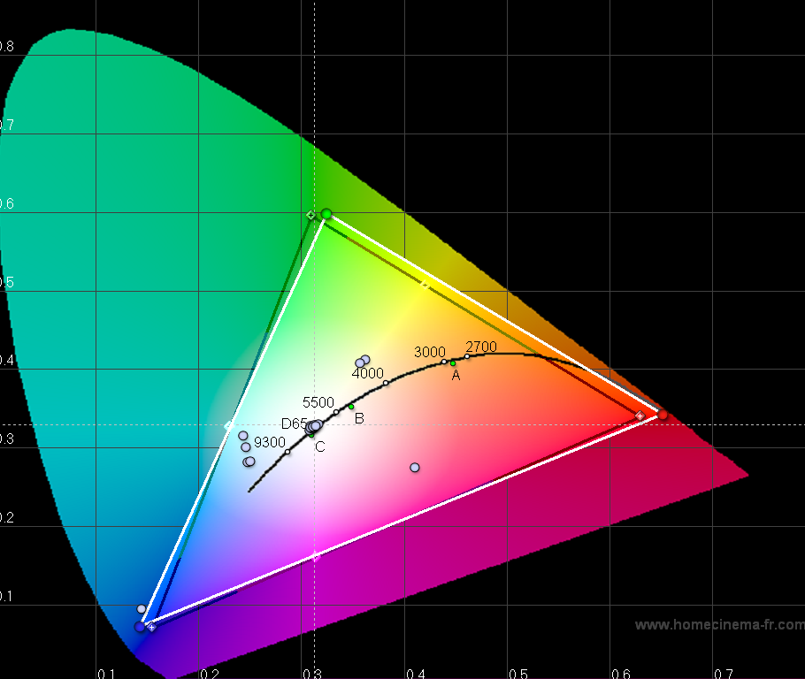

When the MS 07 Tubes are simmilar to SD 187 tubes, there is a lot of glycol in there.
I do not understand the hype on filtered lenses. With glycol out of SD 187 tubes i got nearly the full SRGB color room.
Mabe it would be a little better with better glycol (the SD 187 i had in the moment seemed to be more colored but changing again is a lot of work).
In PC aplications i know that a "bigger" color room is not better all the time.
I know that sitting in the front of an adobe RGB screen, normaly all aplications without color management show me totaly overdriven colours. I don't know what is on blu rays? SRGB?
