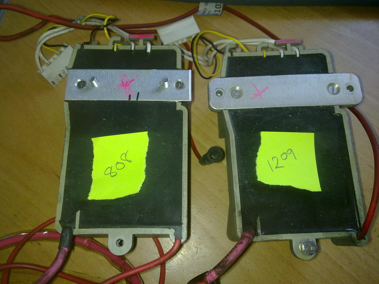

100Bugs + Shipping is a lot of money for an old barco 700. I bought for a friend a Barco 701 with only a few ours on the T 180 tubes for 10€. Shipment cost 40€. The Barco i had here is only for fun, so give me a few days to think about investing thins money. I know that when you not need a PJ its very cheap to buy.
I found the picture below in the www. I think the 808 one is the Quad of my Barco to (7622091), but wich one is build in the Barco 800? If it is the 1209 one, i can use the bootom plate of my xxx91 one and drill a whole for the HV cables into my chassis.

roland@b4
Joined: 07 Jul 2009
Posts: 82
Location: Reading UK
Posted: Thu Dec 30, 2010 2:01 pm    Post subject:
Hey that's my pic.
Funny how the world goes round.
I think the 800 will be like the 1209 fitting
If that is the case you will have to loose the lugs off the side by sawing the em off and use the old metal plate from your existing 700 quad
If its the same as the 808 in the pic above you might have to drill a hole in the metal chassis of the power supply as there won't be enough room to use spacers and you mustn't crush the eht leads
