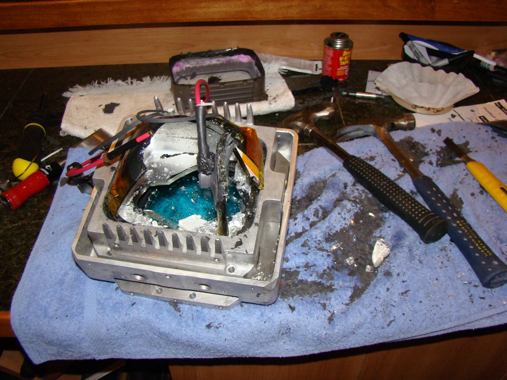

Posted: Wed Dec 01, 2010 2:24 am    Post subject:
That is a LOT better than my result... im still picking glass outta my hair Wink
I can NOT believe that you left the C element in the housing when you did that! Shocked
Scratch up a C element and it's virtually worthless! But you can get up to 300 dollars for a good green C element!
You really didn't have to start busting stuff. Even on an 8" LC chamber, it's not that hard to get the tube out.
You just need patience. Your photo implies that you don't have a lot. Wink
I thought I did... I cut out all the silicone.. I let gasoline sit in there for a day... I got more silicone out. I used Curts hammer method. (Curt you might want to add.. 'put on a diaper when it comes to the hammer part') and BANG!!!! what a mess. That was my first attempt ever at it... I know a little more now but I still would be shaking if I had to do it again.

Posted: Fri Dec 03, 2010 2:40 pm    Post subject:
Aherm. I see twoo things that doesent belong to the set while handling tubes.... two hammers :p

Posted: Fri Dec 03, 2010 3:35 pm    Post subject:
Maybe I had the wrong type of hammers! Curt uses the wooden ones ;P
