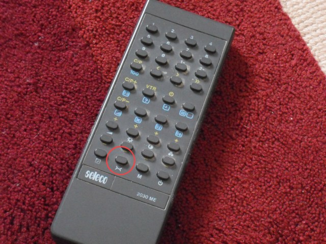

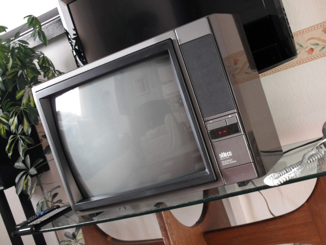

Wonder if someone could enlighten me. I have a little Seleco TV that seems to default to preset Colour | Brightness | Contrast parameters when switched ON/OFF or STANDBY.
I've circled a button on the remote that when selected does the same. Anyone know how on earth you get it to retain your presets, driving me nuts AND the tube as the contrast is too high.
I figured it might be the M button (Memory) but I've tried pressing that and it doesn't work.

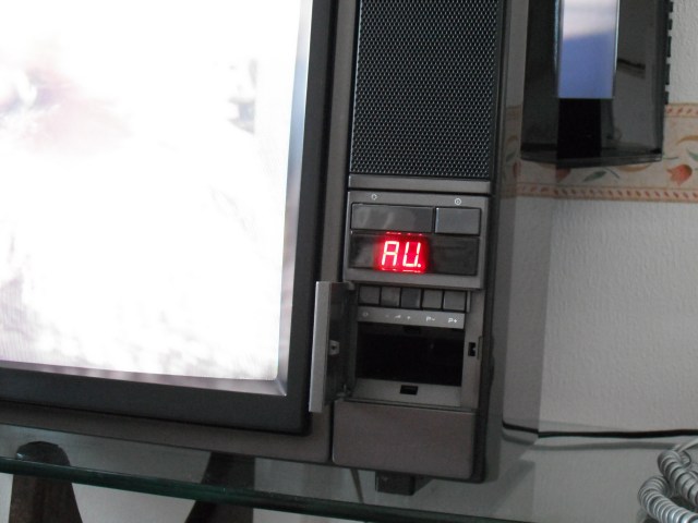

I've added some photos; there's nothing on the television itself.

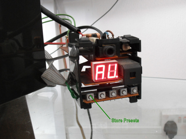

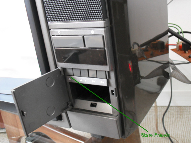

I've worked it out!! I'll post the answer just in case anyone else needs it Razz
The symbol >.< means return to defaulted presets. (Found on the remote)
The symbol <.> means define the default presets. (Found on the TV)
Set the Colour | Brightness | Contrast and press <.> to store.
Problem I had was the button wasn't making the connection to the micro switch.
Rock n' Roll. Thumbs Up
The TV control face.
 Filesize:  87.16 KB
 Viewed:  11 Time(s)
The control unit
 Filesize:  75.04 KB
 Viewed:  11 Time(s)
