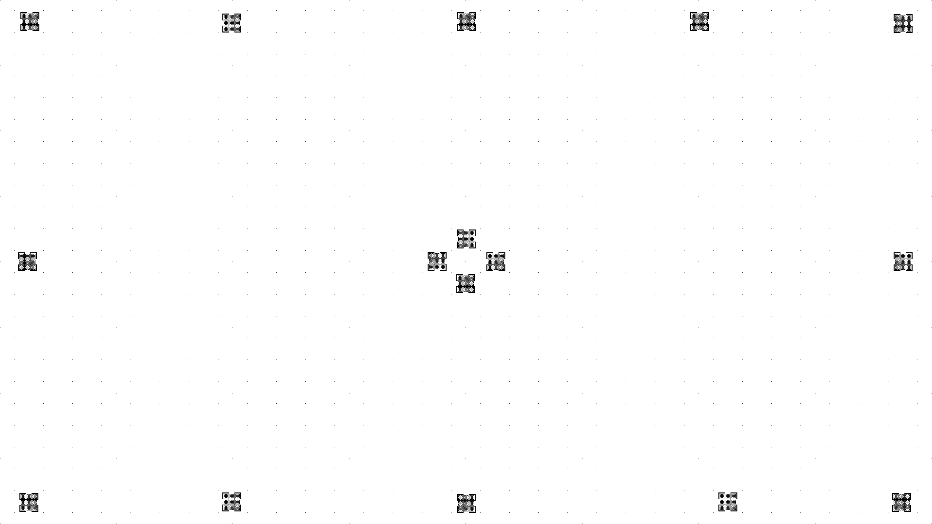

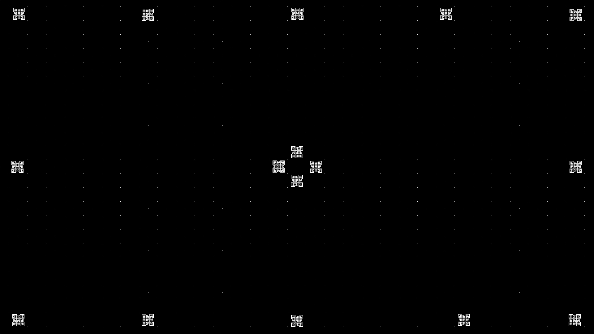

This time I made my own test pattern for doing the EM focus and got better results than I ever did before using the internal patterns. Theirs have the dots with two pixels and I made mine with single pixel dots which seemed to make it a lot easier. I focused on just getting the dots as small and round as possible where in the past I tried to get the scanlines as pronounced as possible - but think I always got more flare than I have now.
Just in case they help anyone else, you can grab them here:
1080_Dots_02
1080_Dots_03

By the way... I like those patterns you came up with, I will try them.
