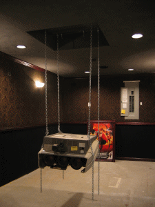

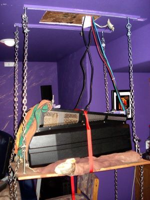

getting this projector on the ceiling wasnt easy even with 2 other guys to help me. There is no place to attavh chains, else I would have gone with that.
You can attach chains via channel nuts in your unistrut. I use a simple platform with long hooks on it and hook the chain to that -- see the pic. With that setup I can put the 8500 on the ceiling in 20 minutes without help.

Posted: Thu Sep 30, 2010 10:40 pm    Post subject:
Gary, great idea. Thanks for the pic.
Is this regular plywood ? How thick is the board ? Will 1" be enough ?
Azi
Posted: Fri Oct 01, 2010 2:49 am    Post subject:
It's regular plywood, 3/4" I think. That's more than enough to support 150lbs over a 3' span.
And here's an illustration (courtesy of Clarence) of how you use it. He hooked the chains to the Marquee itself, but that makes it a bit hard to get it right up to the unistrut. The plywood platform works well for that.
