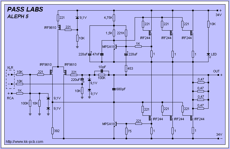

Posted: Mon Nov 15, 2010 8:09 am    Post subject:
I have a Pass labs Aleph 5 class A 60wpc stereo amp. It kicks some serious ass with the proper speakers ! Also great for heating your house in the winter........... Wink
