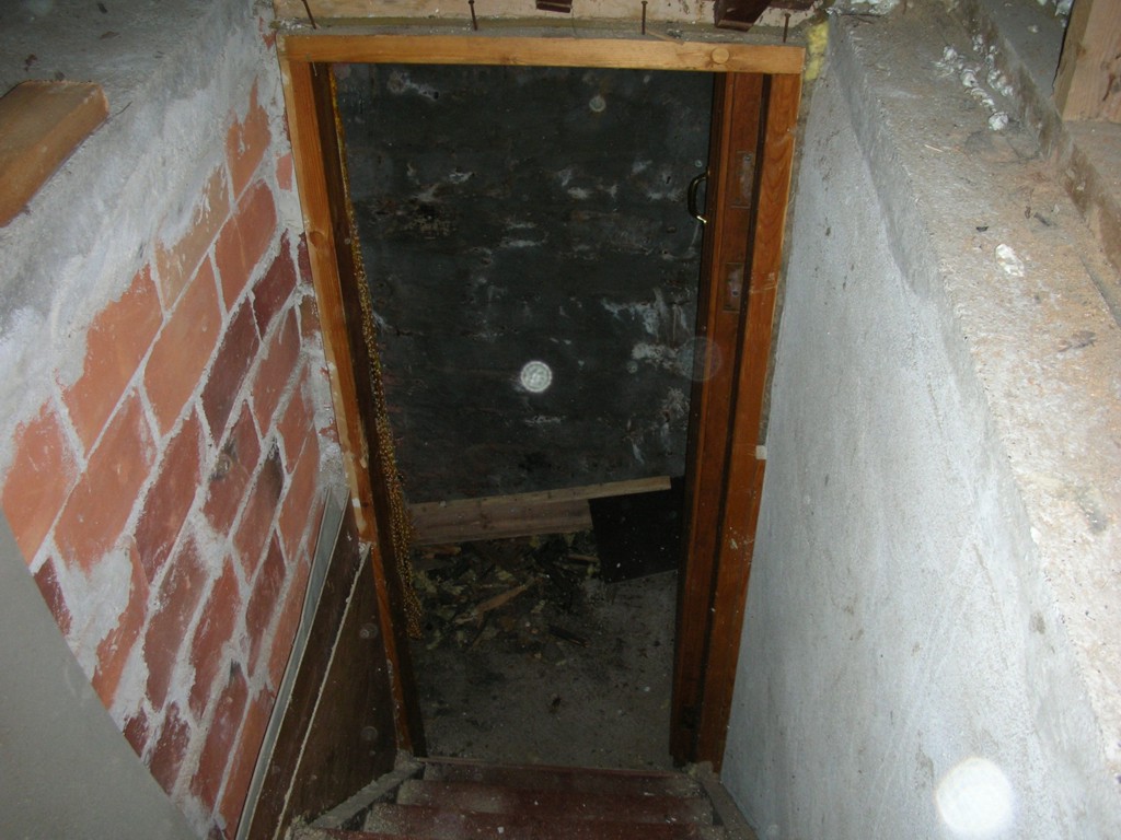

Finally got new HT project started. I'm making new small theater room 2.7m x 5.2m to current cold storage behind garage. There is also 1/2 potato cellar under that storage room. I also have to cut some more room from garage. Room have door from backyard terrace, so it will be pretty good separated from other house.
Biggest challenge is to get old 100 mm (4") thick concrete floor removed from storage room, so I can cast new one to same level with garage floor. Thumbs Down I wonder why the hell they build potato cellar 1/2 way, so only bottom half is under ground. Laughing Maybe there was bedrock so high and they didn't had explosives.
There is only one good thing with this bloody cellar, I can use it for IB subs when I'm casted new floor. Laughing

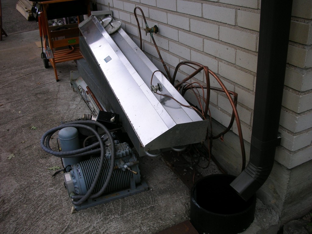

I have already ripped some storage and cellar structures out, like refrigerating machine and some wood paneling.
Need to make ceiling and insulation pretty fast, before it go under zero Celsius. Then I can start battle with concrete floor and brick wall.

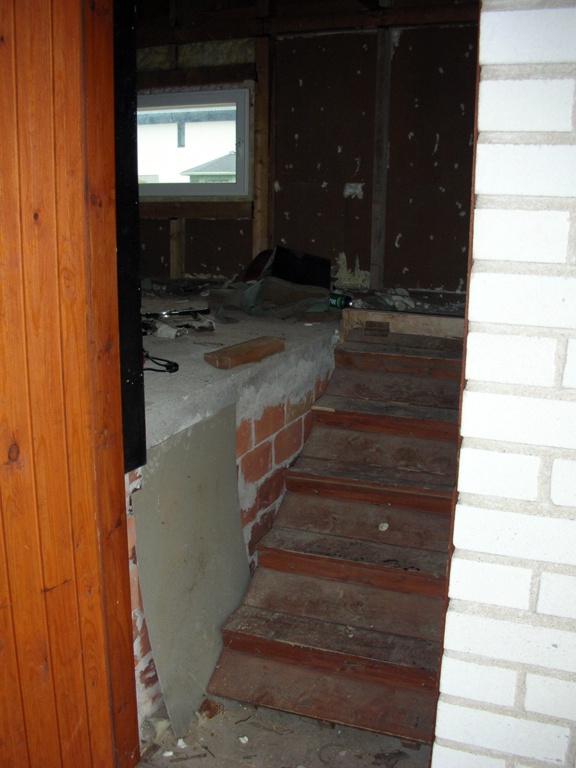

Here's few pictures of current very early state of project.

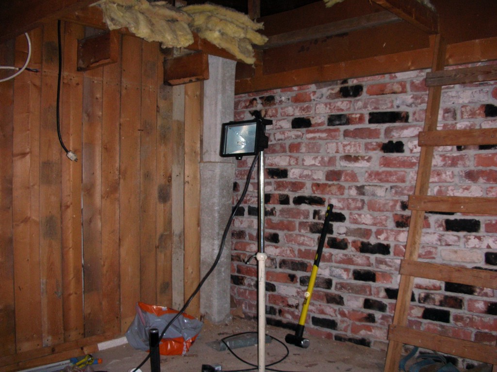

 Filesize:  180.27 KB
 Viewed:  43194 Time(s)

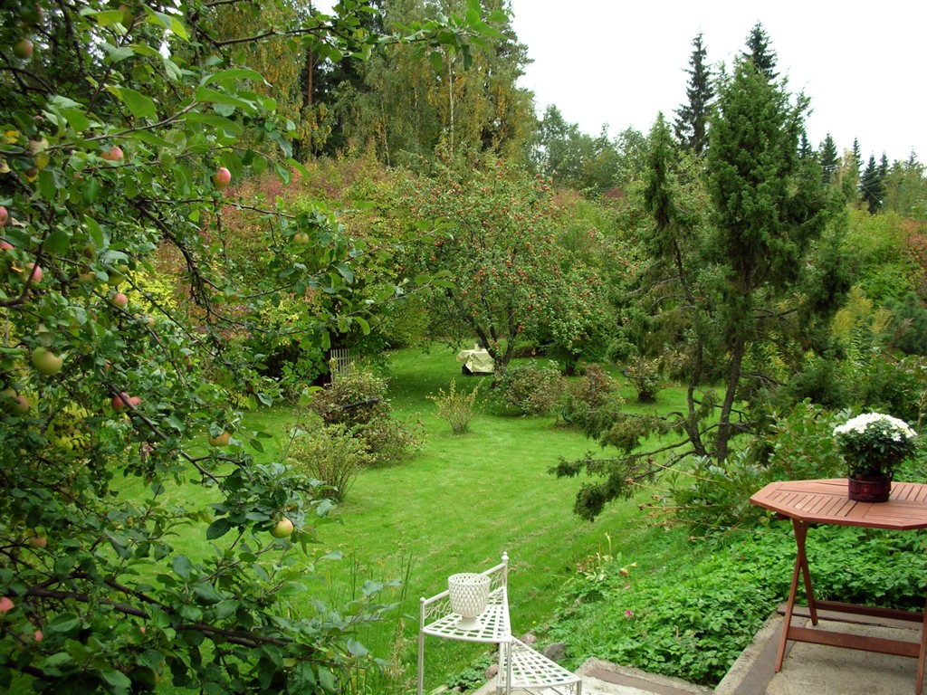

Posted: Mon Sep 13, 2010 7:00 pm    Post subject:
WOW. With a backyard like that, who wants to go inside to watch a movie!!!
Posted: Mon Sep 13, 2010 8:44 pm    Post subject:
Those pics make me miss Europe.
Love the dual purpose Stairs/Ramp, My Papou had that at his house.
Looks like it will be a nice little room.
Will this be a second theater?

Posted: Mon Sep 13, 2010 8:46 pm    Post subject:
wow, incredible back yard. I think I could make a living sitting out on that patio!

Posted: Mon Sep 13, 2010 10:45 pm    Post subject:
Back yard looks good right now in the end of summer, lot of berrys, apples and plum. Few weeks ago we planted few raspberry and cherry plants for next summer, hope those last coming winter.
First one to this house. We moved to this house in june, so haven't got theater after that.
Haven't actually missed theater in summer, but now when it's getting cold and rainy I could use one. Very Happy
Kids love those dual purpose stairs and storage, they call it summer room and they slept there few nights in July.
Haven't seen many that kind stairs in here, maybe those are more common in southern Europe.

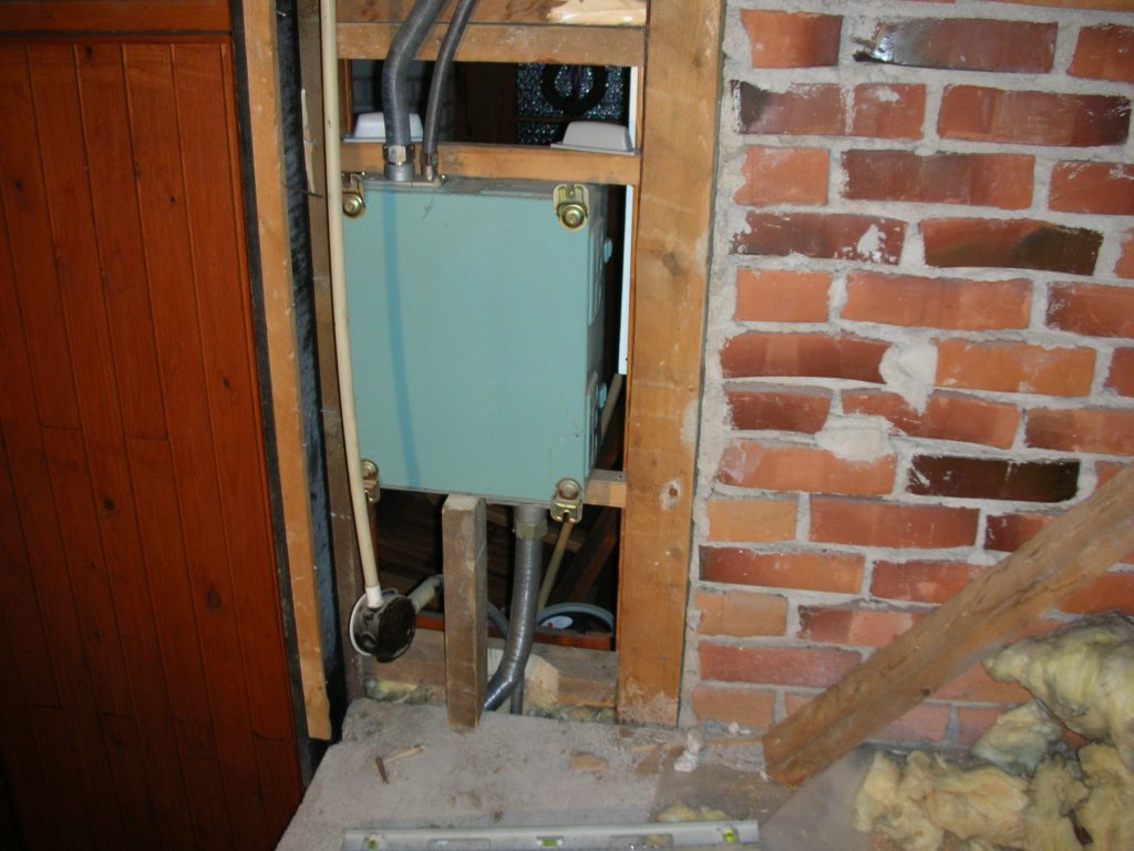

Posted: Thu Sep 16, 2010 9:52 pm    Post subject:

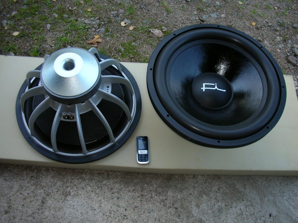

Got new subwoofer elements for IB today, found two new in box FI IB318 elements almost locally for fair price. Very Happy
Moved electricity-meter cabinet to outside wall, it was built inside wall. Now I can make room bit wider.
Cabinet is old, but company chanced meter few months ago to new one that can be read by gsm. Grey antennas can be seen over box.

Edit. I guess that brickie must been pretty drund when he made that wall. Laughing I'm heard that was not so uncommon here in 60-70'.

Posted: Fri Sep 17, 2010 2:42 pm    Post subject:
That seems to be the norm everywhere. I worked on an historic house in DC, built in 1701 (I know, that is hardly historic by European standards). We found many bottles hidden in the brick walls.
