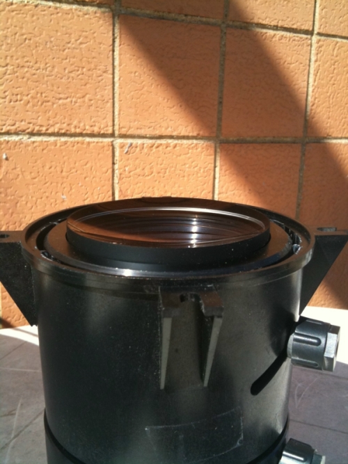

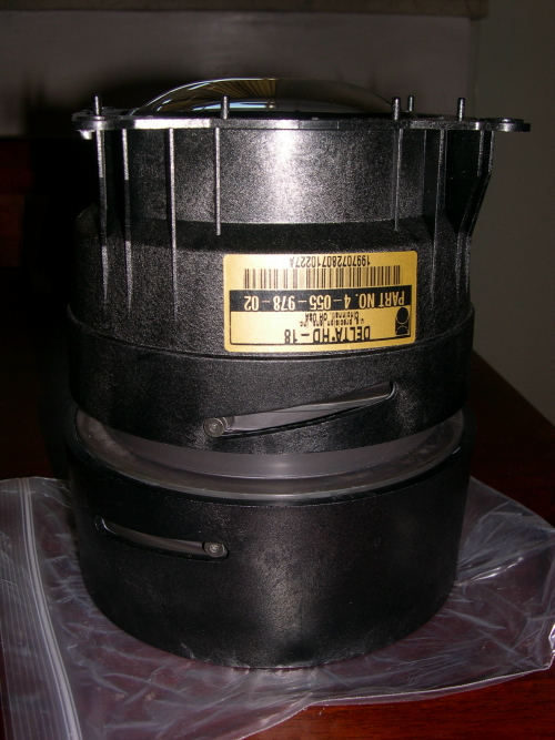

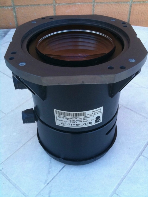

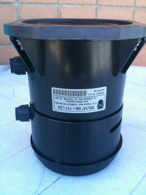

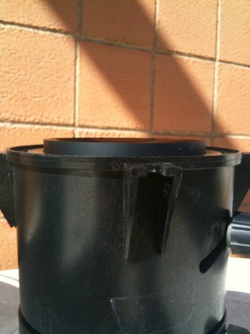

The set of lenses just arrived.
Watching them I have now a big doubt: the rear lens is concave Shocked Shocked Shocked
It would not have to be convex like in my HD18 set?
Le lenti sono appena arrivate.
Guardandole ora ho un grande dubbio: la lente posteriore e' concava Shocked Shocked Shocked
Non dovrebbe essere convessa come nelle mie HD18?

Posted: Wed Oct 06, 2010 12:32 pm    Post subject:
I think color filtered 8" c-elements (same for HD-18, HD-134 and HD-215) have different radius for concave than Barco 8" c-element (HD117), so those probably aren't working correct when mixed.

Posted: Wed Oct 06, 2010 12:54 pm    Post subject:
So I must swap color filtered c-elements with original clear Barco c-elements?

Posted: Wed Oct 06, 2010 2:34 pm    Post subject:
Probably. Don't have first hand information, but remember reading about this.
If c-elements have different concavity, glycol between tubes face and c-element forms totally different lens that have wrong optical properties for rest of lens assembly.
But you can compare G70 and Barco c-elements concavity if you have both there. Cut template from paper or board...

Posted: Wed Oct 06, 2010 3:33 pm    Post subject:
Yes I have both and I'm sure that circumference is the same because I swapped c-elements when I maked LC conversion.
I hope next week to compare concavity.
