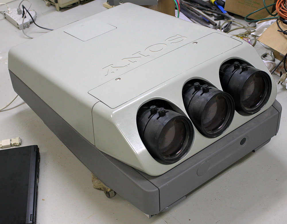

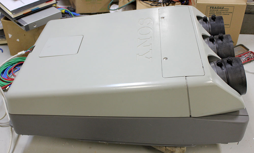

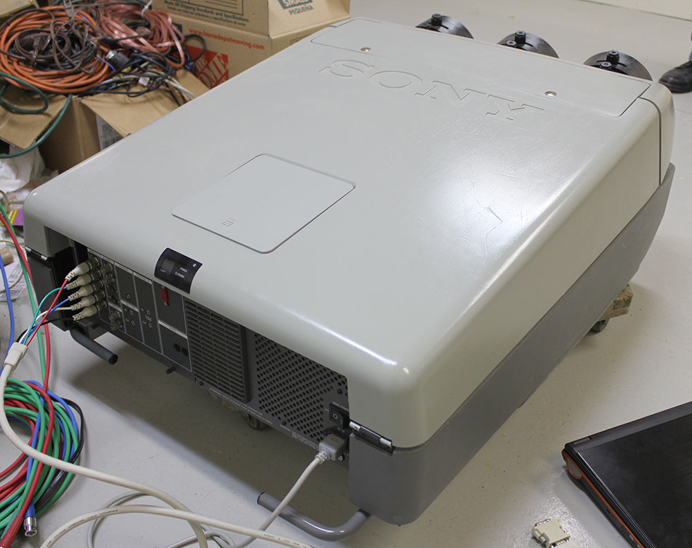

So, I went to see it. It looks pretty good.
First: The guy pulled the Moome card, and all the inputs started working again. Hmm. So, maybe it's an intermittent problem that fixed itself when he wiggled the card (which seems unlikely since he spent a bunch of time reseating things) or there's some fault with the Moome card that's causing the PJ to not take input. If that's the case, celebrate, because I don't particularly care about HDMI input. It might be nice at some point, but it's not a huge deal. Also there's the HDFury that comes with it...
Or he missed some config thing, and on page two of the Moome manual it says, "Do not accidentally bump DIP switch 2, or all inputs will be disabled" or something.
Impressions vs. my Barco-
* It's bright as HELL. Maybe he has a really freaking high gain basement wall, or maybe my barco's tubes are just worn out. Dunno. But I was shocked when it fired up with a similar size image EASILY visible in flourescent light.
* It's reasonably quiet. Not much louder than the Barco; maybe quieter. The fans are higher pitched, though, and have a beat frequency that the Barco doesn't.
* Christ, that thing was bright.
I didn't have time to do any checks on focus, etc.

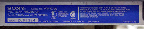

I did get some pictures. Anyone know a rough build date from the serial?

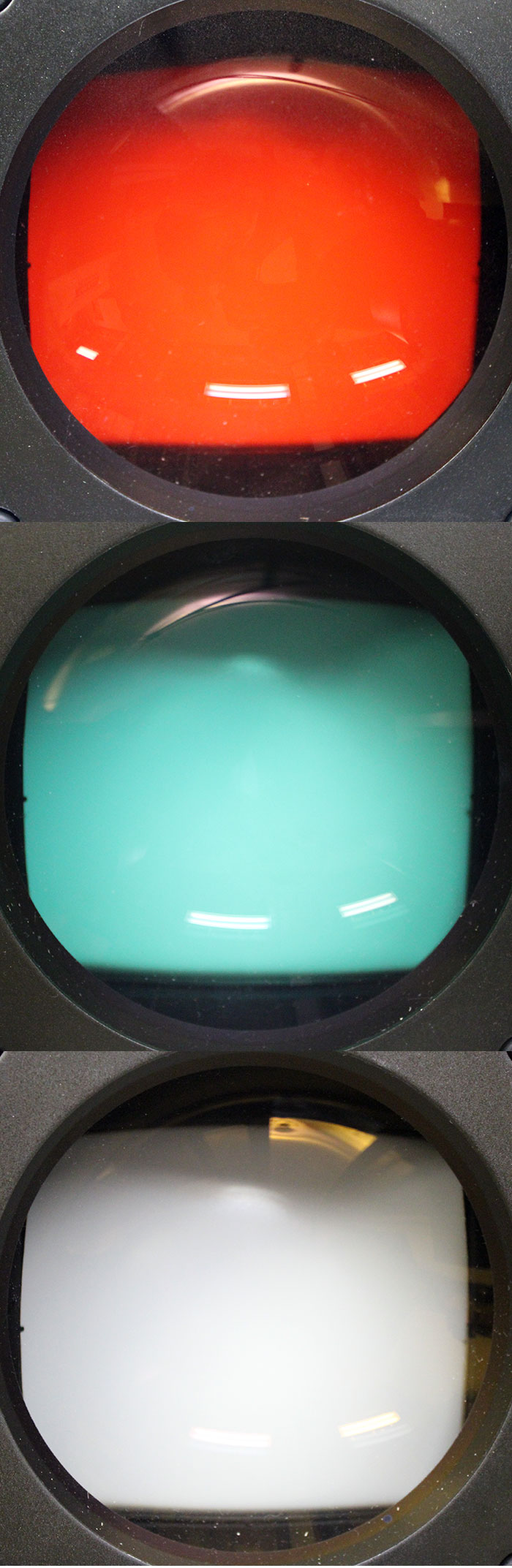

I think I can live with the tubes...

Personally, I've had a LOT of bad experiences with ANY Moome device. It doesn't surprise me one bit that pulling it solved the issues with the projector. The Moome devices I've had, have been great examples of high percentage defect buggy crap with virtually no evidence of quality control...
Those tubes look excellent.
