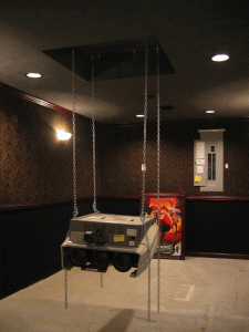

Posted: Sat Sep 04, 2010 1:52 pm    Post subject:
Yes, the wired remote can be removed and used with a battery. You're good there.
Consider building a hushbox (with external air circulation) instead of buying covers for it. The 'Quee isn't that svelte and beautiful to look at anyway. It's not a very noisy projector but a hushbox will improve your viewing experience.
Definitely pull the lenses and get a sense of the tube condition. Post pix here if you can. That makes a HUGE difference in what it would cost you to get it running.
Look through the lenses to see if there is any damage to the C-elements. If he took it out in the sun, the lenses can cook the C-elements. If YOU take it out, cover the lenses!

I think "easily" is stretching it quite a bit!! Very Happy It still weighs 150lbs, maybe 20-25lbs less if you remove the lenses first. And it's an ungainly beast to carry -- the Marquee has no handles. You need to wrap some straps around it so you've got something to hang onto. It is definitely possible to hang it without assistance -- I've done it several times -- but only with some mechanical cleverness. Winches, pulleys, or a chain lift will do it.
