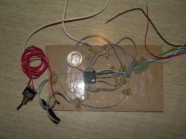

Craig, this is where I left off with the ic you sent me. I haven't attempted a read yet which is where I will be picking back up. Still dont know if it will read or not. I have almost always been able to get a read on the 100's of various other chips I've tried on but I must admit I'm not real confident on this one. Hopefully in a couple more weeks I can get back to it.
Trouble still remains even if you get a read of that defective chip... cause it will be hard to convince someone with a good IC421 to let us take it off the board just to do a read on it and then put it back. Lots can go wrong with all those tiny little pins during removal and installation.
But then again, the software might not be what's bad on the IC, it could be the hardware. But my guess is a software issue in the write once memory. And that beings said calling the software software is a little strange when it is hard written.
The manufacturer of these chips, or a chip the same case style should have an evaluation test board available. It's no more than a small board with the chips footprint on it that also has where you can make connections to it.
I don't think we ever even got to the bottom of who manufactured this chip. One of the Japanese data sheets I have says LSI, but that might also mean Large Scale Integration.

Posted: Sat Sep 04, 2010 2:10 pm    Post subject:
The chip would not have to be removed from the board to do a read or write if a either is possible. I did this one like this because the chip was already off.
I'm also not convinced this chip is a OTP (one time programmable). JTAG chips usually are not.

mp20748 wrote:
That chip has a standard industry footprint, which is a common size and pin layout that is also shared by most chip manufacturers.
The evaluation boards should always be used when trying to operate these chips outside of it's designed PC board. They are extremely sensitive to static damage. And that's why it's best to not operate it away from the board.
Even the video chips that I do my R/D with, I get the evaluation board or spit out a mini board design to place it on before doing anything to it.
Ah..Hmmmmmmmmm.
Do I really have to explain why I did it this way?
Posted: Sat Sep 04, 2010 2:52 pm    Post subject:
macgyver655 wrote:
Ah..Hmmmmmmmmm.
no!
I'm sure you have good reason, and I would probably agree.
