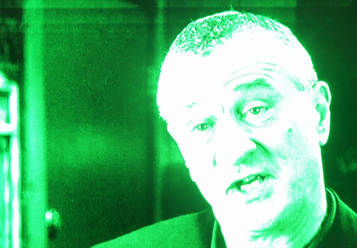

Dear Experts,
The image quality that my BG 1209s/E produces is flawless, except for one problem that has appeared recently. There are some horizontal "shadows" at the top of the screen, which come and go randomly (please see the attached .jpg file). When they are visible, they are present in all tubes, and does not depend on the image sources (I've tried different players, cables, HDFurys, and so on...).
The shadows first appeared after the lightning struck (without warning) VERY close to our flat. Maybe the events are unrelated... Or maybe not?
What do you think?
Some set-ups that I've tried (both give the same result):
Standard set-up: HTPC (Radeon 4890) @ 1080p/60 -> Clicktronic 10 m HDMI-HDMI -> HDFury3 -> BG1209s/E port 5.
Alternative set-up: Sony blu-ray player @ 1080p/60 -> Supra DVI-DVI 10 m -> HDFury1 -> BG1209s/E port 5.

Posted: Sun Aug 29, 2010 6:21 pm    Post subject:
Do they roll up or down ?

Posted: Sun Aug 29, 2010 6:49 pm    Post subject:
Good question... Actually, I don't know... It's really hard to see. It seems that they are quite "stationary" when they appear, as shown in the jpg. No major (visible) rolling. Just "fixed" horizontal shadows, which now and then change appearance (e.g. different number of "shadow rows") or disappear.

Some new information. When displaying a static image, the shadows are there all the time. They don't come and go "randomly". This only happens when watching a movie. Apparently, the contents of each frame is important for provocing the shadows.
Also, displaying the (Barco) menu has an impact on the shadows. The number of "shadow rows" decreases when the menu is shown.
Finally, when there are many "shadow rows" (about 4), there is an audible buzz from the power supply. When there are fewer shadow rows (e.g. when pressing the menu button), the buzz is inaudible. Also, the variations of the buzzing sound matches the visible interference, or variations, around the shadows. Shocked Wierd! What's going on?
Do I have a faulty power supply?
