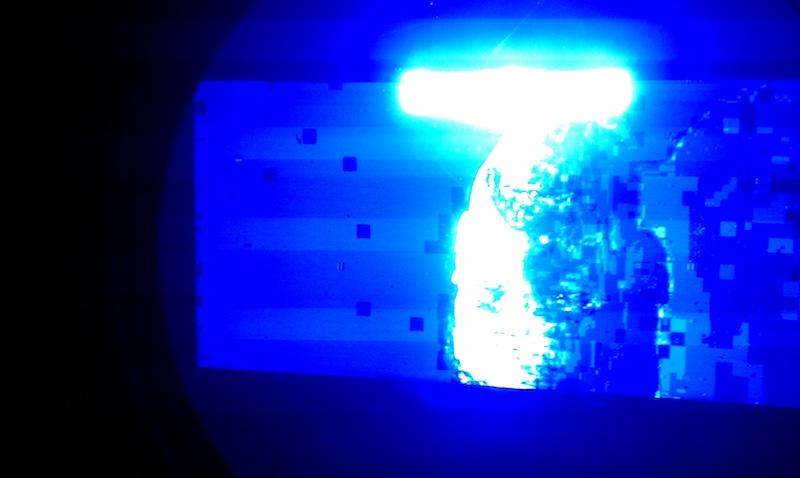

on the BD808 tubes (red and green) the number is 1091911
on the BG808s tube (blue) the number is 1100624
The blue tube dosn't focus as sharp as the red and green, and in scenes with a single source of light and the rest black, the blue lights up (barely noticeable on screen) and pixelizes. The photo is a scene from There Will Be Blood, and like the other tubes, should be only a figure and the rest black. If I turn the brightness and contrast way down the tube doesn't act this way anymore, but the rest of the picture suffers.
Also, using switchResX for my mac, I got 1280X720 @110hz to work. Other resolutions and frequencies I got to show, but it seems that all the vertical syncs are off because the picture moves down rapidly and reappears at the top about 8 times per second... any ideas?

Posted: Wed Aug 25, 2010 8:14 am    Post subject:
1&2
G2 seem to be too high, least for for blue.
That pixelation is normal packing artefact for dvd black areas, when G2 is adjusted correctly that crap can't be seen at screen.

Posted: Sun Sep 19, 2010 10:33 pm    Post subject: Just to document...
I spent a bit of time researching more, and toying around with the projector, and I finally have it looking very nice. The few things I did to the blue tube were:
1.) I turned down the G2 on the tube, and corrected the color balance on the rest to match. Without a color meter, this was difficult to get 100% accurate, but after trying my best, and watching a few hours of different films and tweaking, I got good results. Now, the blue tube does not produce the same black haze.
2.) I said that the lines were thicker, and less focused on the blue tube. To fix this, I discovered the problem was with the pole magnets on the tube. It looks as if they were never properly set, and after a short while I got the image nice and sharp.
3.) The extra lines on the phosphor just went away after time, I am guessing that it was a loose connection, and I bumped it into place while adjusting...
