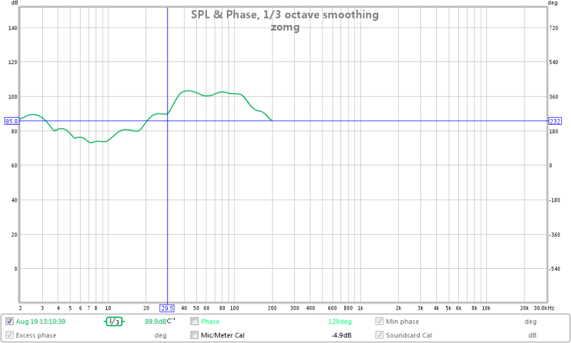

Posted: Thu Aug 19, 2010 5:35 pm    Post subject:
OK, I did have a miswire on one of the subs that was doing some phase canceling. After fixing that and adding my final sub, which went in the corner rather than behind the couch...
Maximum output *while retaining clean output on each sub*. This was checked with the scope individually.
That's full scale, with correctly calibrated radio shack meter. So, that doesn't seem so bad. The question is, what's it SUPPOSED to be... Unfortunately I don't have EQ detailed enough to distinguish 50 from 40 from 30hz, which is really what I need.
Posted: Fri Aug 20, 2010 3:56 am    Post subject:
That chart says you're down about 25dB at 10Hz -- but 15dB at **2** Hz!? Or is that greeen line the phase, not the SPL? The chart says it's both but there's only one line so I'm guessing it's phase.
