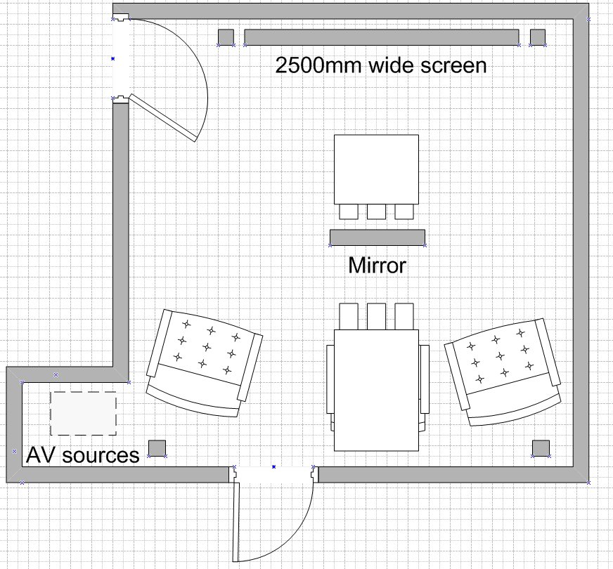

Posted: Tue Aug 10, 2010 2:56 pm    Post subject:
Rough idea of the room. 6ft ceiling in a 300yr old cottage. G70 above main seat.

Posted: Tue Aug 10, 2010 3:30 pm    Post subject:
Maybe put the g70 behind the seats facing up into the mirror?

Posted: Tue Aug 10, 2010 9:12 pm    Post subject:
""Maybe put the g70 behind the seats facing up into the mirror?""
This has been done and worked OK according to what I heard 2nd hand,
of course with such a low ceiling height, there will be issues no matter what you do.

Posted: Wed Aug 11, 2010 12:14 am    Post subject:
Put the mirrors as high as possible and adjust pj height accordingly?
