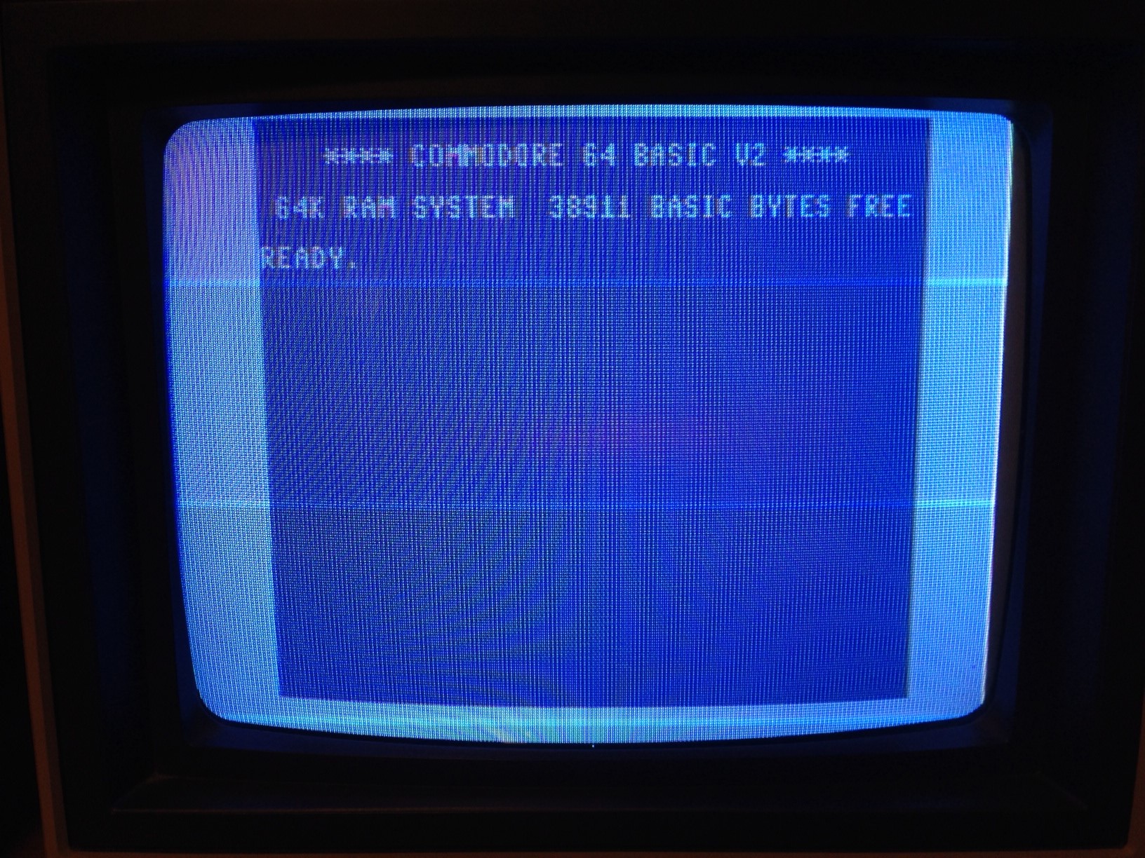

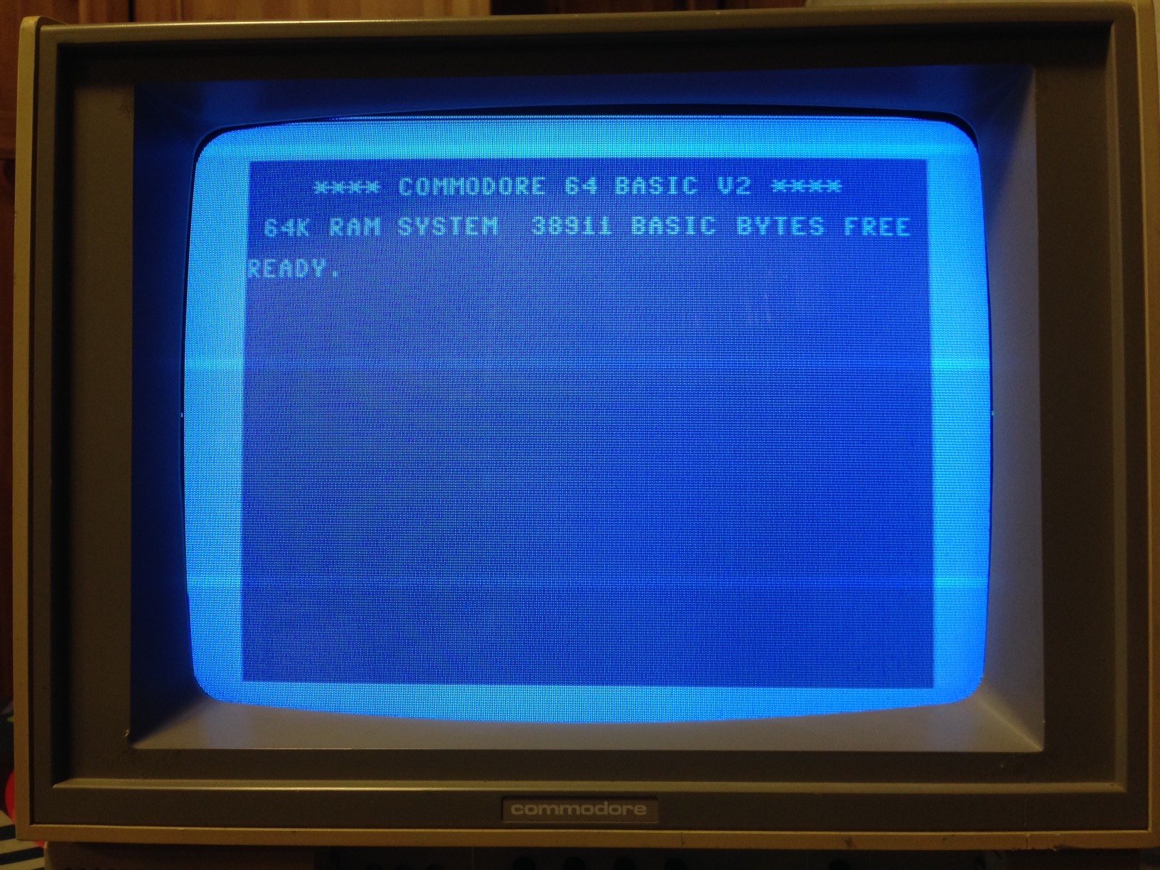

I connected the C64 to a 1802 display with true chroma and luma. Attached is the result.

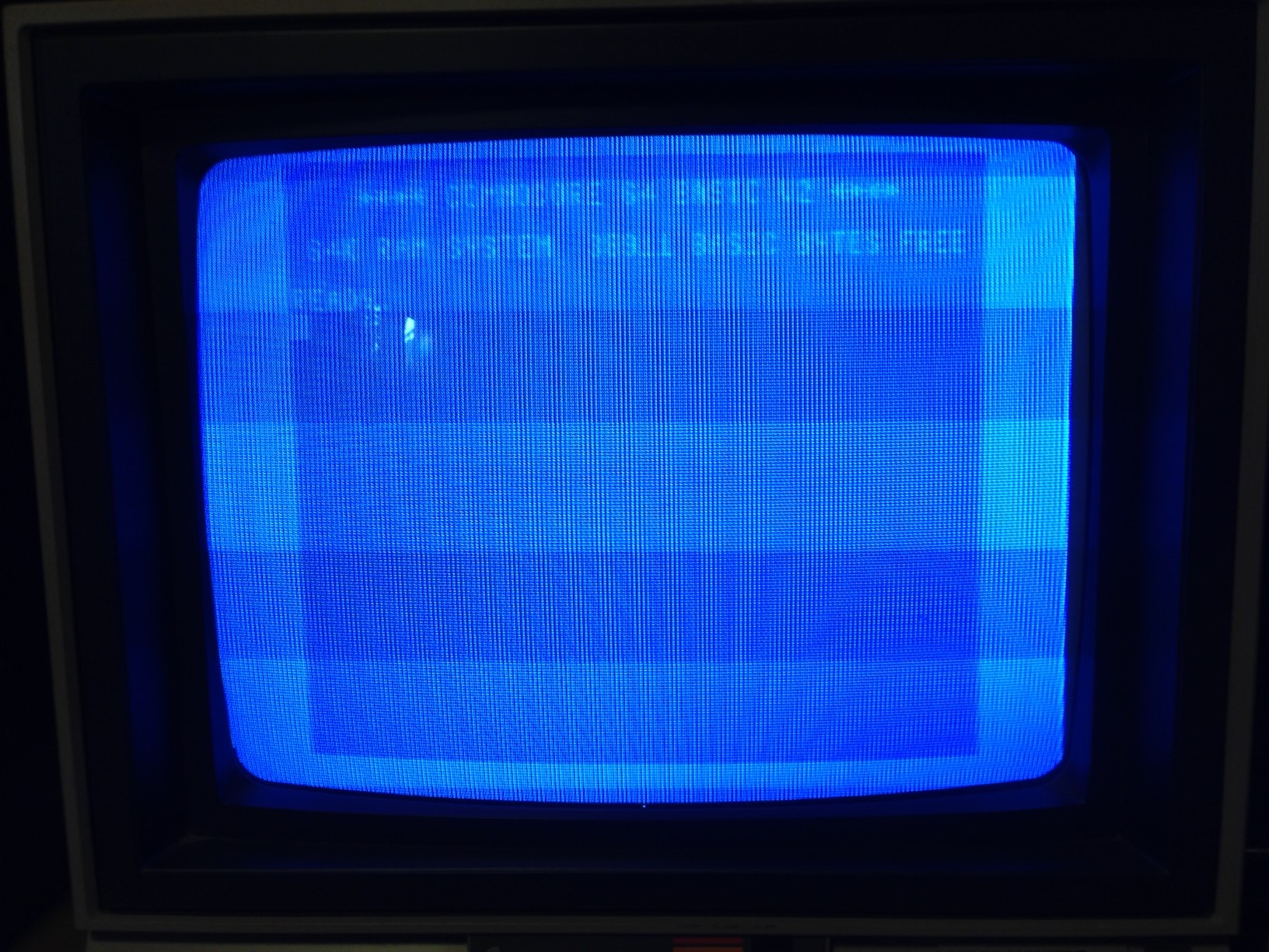

Next, attached is the 1702 (which has the issue) connected to the same C64 with true chroma and luma.

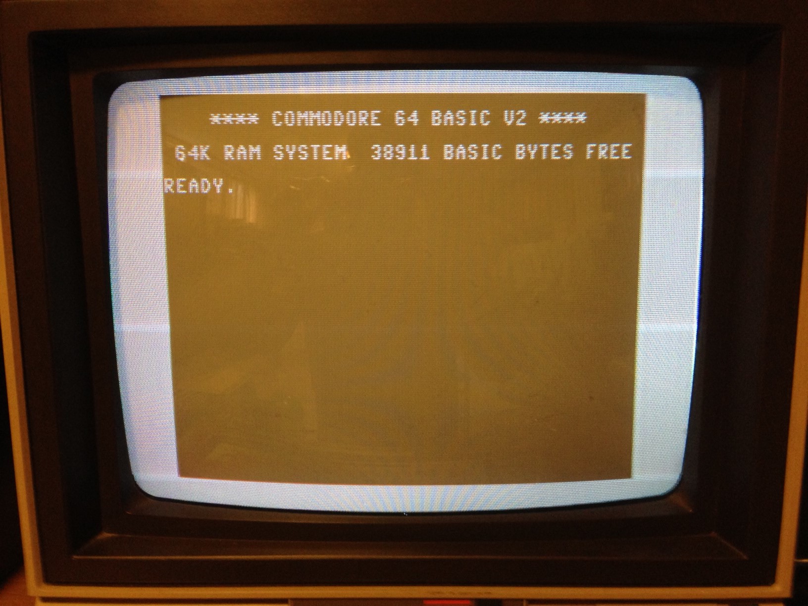

I then tried using just luma on the 1702 and the picture quality is much better (though it is only black and white). See attached.
Finally I tried another C64 which only has composite and luma outputs. I connected it to the 1702 using composite as chroma and there is some improvement but not close in quality to the 1802. See attached.

Posted: Mon Jul 14, 2014 10:25 pm    Post subject:
Are the bars in the pictures scrolling upwards?
As for fixing it. Maybe. It could also be used, used, used. The tubes in these monitors are ES focused, (Electrostatically Focused). The beam is focused through an aperture ( hole ) and, as the electrons fly through the apeture they erode the surrounding material. Lessening the beam focus as the tube ages. Giving you a softer picture.
Now, that being said. This wouldn't account for the bars in the pictures unless those are just a by product of your camera? That could be electrical maybe a ground on the jack, bad solder joint. Capacitors may be dried out too causing electrical gremlins.
You can tweak the focus on the flyback (High Voltage transformer) but it may already be tweaked. You can also try the astig rings on the tube (watch out for the 400-600volts there )to see if you can get a smaller dot size. Keeping in mind they tended to do that at the factory and then glued the rings in place. There could come a point of diminishing returns.
The bad focus could all be a by product of age.
What end of T.O. are you in BTW?
