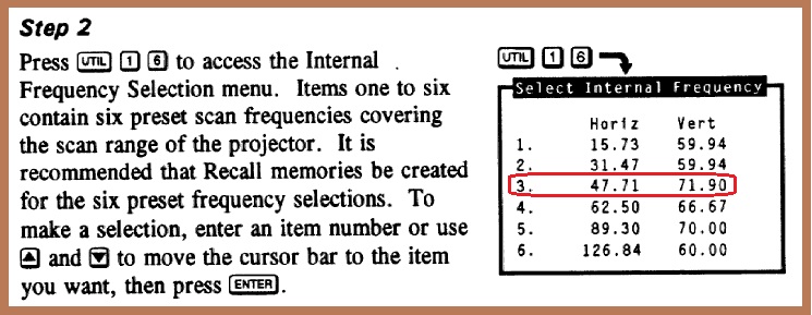

When I select internal resolutions #1 & #2, I get clearly visible scan lines.
When I select #3, the scan lines seem to come & go. I can walk right up to the screen and every moment or so I feel like I can see the scan lines briefly flash.

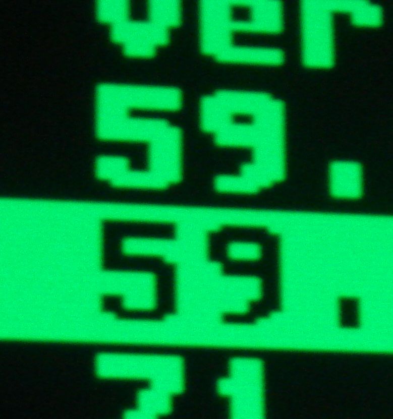

Those videos, with the flickering &etc -- did it look that way in person? That looks more like what frequency #1 looks like on my PJ -- flickery, and I can see the scan lines if it'd just hold still. At the start of the video I thought it looked more like a moiré from an external source than like actual scan lines. The lines were waaay too big.
I just looked and I can faintly see scan lines with freq #3, if I'm within a foot or two of the screen. And my focus is not ideal by any stretch. I tried to take pictures but my crappy P&S camera doesn't focus right in the dark. Even so, you can clearly see scan lines with freq #2. The lines on freq #3 were slightly harder to see.

Internal freq #1 is interlaced. That is why the you see flicker. One set of lines (field) are scanned then another are scanned in between the first set, repeat. This takes two fields at 60 times per second (60Hz) or each set is there 30 times per second. Slow enough for the human system to begin to see.
You can approximate the number of scan lines by dividing the horizontal frequency by the vertical. Internal freq 3 is 47,710 (H) / 71.9 (V) so 664 scan lines. Actually a bit less because of vertical blanking time so about 95% of the 664 are displayed or about 630 visible scan lines.
