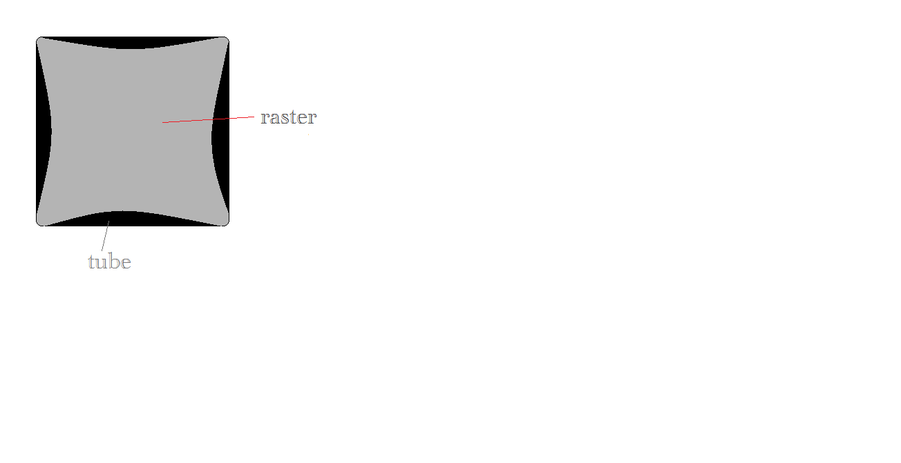

Hi All,
Where do I start to make the raster shape square? Please see diagram. All raster shapes are the same for R, G and B.
Do I start with the Vertical board and adjust the master shift and pot for B and R and height control? Please help.

Posted: Thu Jul 15, 2010 3:25 pm    Post subject:
The controls on the board pots will only adjust height/weidth/size. Not pincushoning. You need to go throug the step-by-step on screen guide.
Posted: Thu Jul 15, 2010 3:50 pm    Post subject:
Do a 'set to midposition' in the service menu. That will zero out all controls to the default position, and then do a 'guided' setup.
